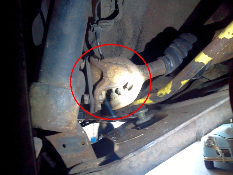

1. 206z REAR BRACE PHOTO. When I decelerate quickly or when I shift gears, I hear a big metal-to-metal "clunk" sound that is clearly from the rear end of the car. I thought it was a drive shaft issue or perhaps a rear diff mount, but upon examination those seem secure.
Please look at the rear frame bracket (first photo) that holds the rear end to the frame. The joint holding that piece to the frame is circled in red. Note that the photo was taken with the car on a lift, so the suspension is relaxed and extended.
Is there a name for this bracket? Is there perhaps a gasket here that could be worn or missing? Could that account for the big "clunk" described above?

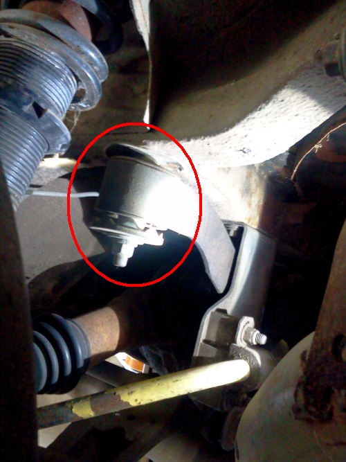

2. 260z HALF SHAFT PHOTO. This is a picture of the rear drive shaft/half shaft. The passenger's side has no play it in whatsoever. The tire will not rotate when the car is in first gear, with the car on a lift, attempting to turn the tire by hand.
However, the driver's side has a bit of play. With the car in gear and on a lift, I can slightly move the tire and see the tiniest bit of play in this half shaft joint.
Can you tell me the proper name for this joint? And can you tell me if a slight amount of "play" is acceptable, or is that cause for immediate replacement of the joint? We had to replace this part several seasons ago and I am concerned that it might go out again.

In picture 1, that is commonly referred to as a moustache bar, Nissan refers to it as a compression member - differential. Picture 2 is just a half-shaft U-joint. The moustache bar has a big rubber bushing pressed in at each end, yours may be well worn from track stresses. Swapping them out is a bit of a PITA. There should be no play in any U-joint - driveshaft or half-shaft.
I replaced mine with Hyper Flex polyurethane. It wasn't too bad with this Tech Tip for reference, thanks Blue.
http://atlanticz.ca/zclub/techtips/moustache/index.html
It's hard to tell when the diff mount is bad. The rubber will look okay but if you stick a long screwdriver or pry bar between the top and bottom plates and pry you'll probably find that it is weak and separates easily. When you accelerate the nose of the diff will stretch the rubber and when you let off the gas it will drop down and the top and bottom plates will hit, or the front of the top plates will hit the cross-member. Check the distance between the top and bottom metal at the front of the mount. There is a actually a spec. for the distance between the two plates.
Everything that you're asking about is described and illustrated in the Rear Axle chapter of the FSM. The diff mount is called an insulator and the "half-shaft" is called the drive shaft. What we call the drive shaft is known as the propeller shaft.
Index of /FSM
I agree with Zed Head. If the mustache bar rubbers look like that then the diff mount it probably shot as well. Replacing the mustache bar rubbers with originals is a right PITA. Redat on ebay sells them, but most people change over to PU bushes. Siteunseen posted a link to a great sight to get detailed info on how to do this.
The uni-joints are easy to replace and readily available through Rock Auto, MSA etc. I would change all four, but that is just me.
Chas
