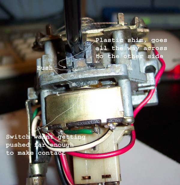

I had a problem with my turn signals. It turned out to be a worn assembly/switch on the end of the indicator stick. I would only indicate right if i pushed it really hard.
So i pulled it out the whole assembly, loosend up the screws that held the switch on the end of the stick and repositioned it.
Now no left or right.
What had happened was the plastic bush type thing that switches the switch has worn out, so that when you push the lever it rocks a bit and doesn't fully push the switch.
So i wedged a thin piece of plastic between the metal part that holds the lever, and the plastic bush thing.
Now it works fine.
