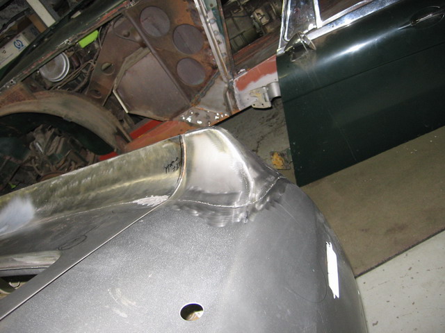

Hi all I have been learning so much from this site and have enjoyed reading everyone else's builds and projects they have taken on. I have a 1973 240z I have had for a bit over a year now and and working on the body work myself. I am thinking about while I'm at it molding in a three piece spoiler but I have done some searching and I can really seem to find them much. I have found one guy that makes them but he wants $355 for them. I was wondering if anyone knew if there was any other places that had them cheaper or if that's I will be looking at if I decide to get one? Thank you so much for all of your help. You are all awesome people!

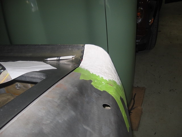

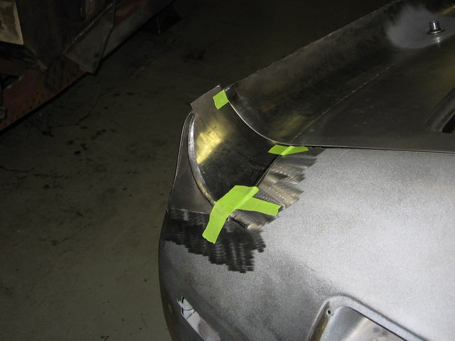

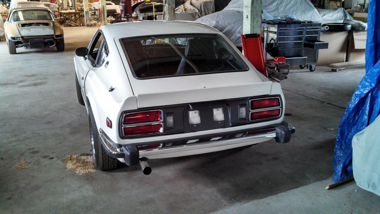

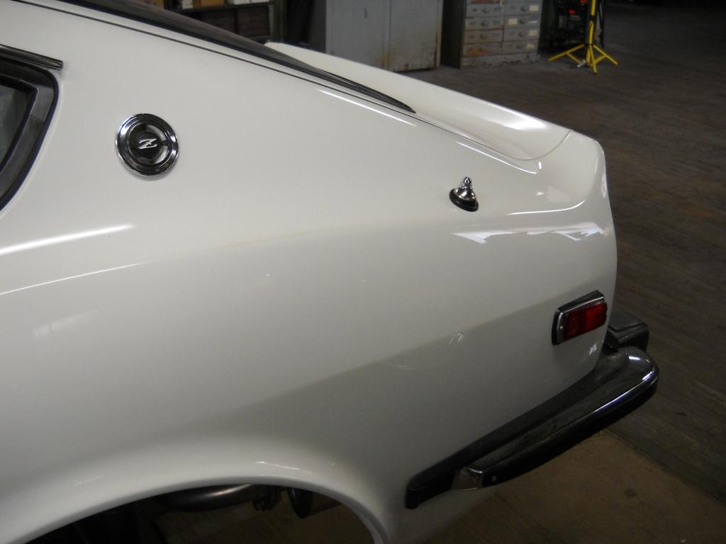

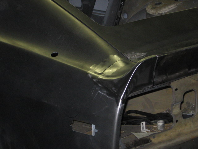

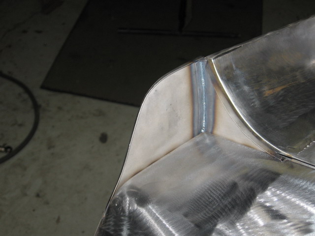

The work was done by Pollock Auto Restoration / Ragtops and Roadsters in Pottstown, PA. Initially, we used modeling clay to sculpt the end pieces, trying to match the contours of the fender and sail panel. Modeling the spoiler with clay allowed us to adjust the height to get the scale just right. It was a fun exercise. Try a little of this, stand back and see how it looked, adjust a little here and there. After we were happy with the design, the metal tech fabricate the pieces to match and welded it in place. A few more photos are attached.
