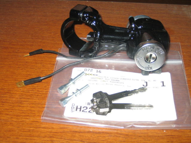

lonetreesteve Posted October 29, 2013 Share #3 Posted October 29, 2013 I had the same troubles on my '71 and bought an NOS ignition lock assembly with 2 new keys on Ebay for $193.00 including shipping. It works great! Link to comment Share on other sites More sharing options...

ZCurves Posted October 30, 2013 Share #6 Posted October 30, 2013 I had the same troubles on my '71 and bought an NOS ignition lock assembly with 2 new keys on Ebay for $193.00 including shipping. It works great!I did the same and it cleared up a bunch of issues I was working over at the time.... I did throw out the 'break-off' screws and stayed with four standard phillips. Link to comment Share on other sites More sharing options...

lonetreesteve Posted November 1, 2013 Share #9 Posted November 1, 2013 Thanks Guy's - have tried the usual Amazon/Ebay path I can't find much for a '74 260. The locksmith rebuild is an option but as ajm states, finding someone to do the job has been a pain.The NOS ignition lock assembly that I bought on ebay will fit '70 through '78 Z-cars. Link to comment Share on other sites More sharing options...
