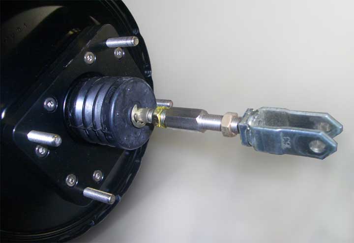

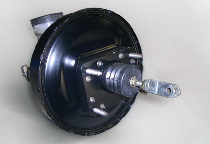

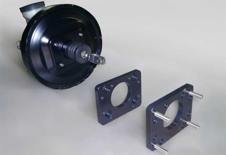

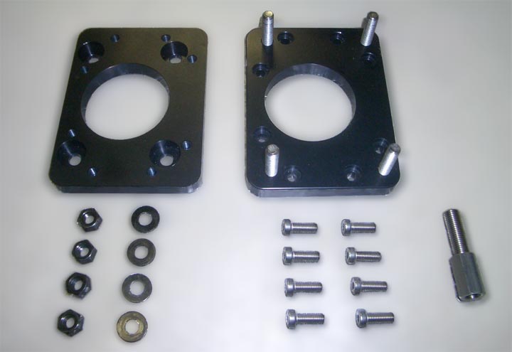

Looks like the original studs are cut short and a threaded adapter lengthens the push rod to make up for the extension of the booster into the engine compartment.
I am wondering if DGV to manifold adapter plates could be used as the concept is similar for coupling carbs to manifolds.
