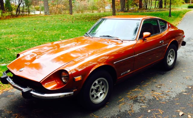

Here she is:

Pretty car!

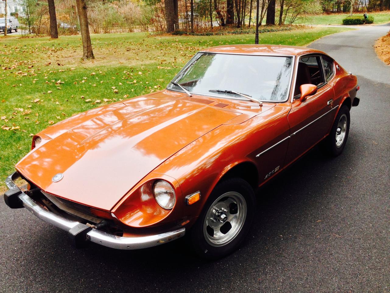

I didn't run it for very long either so it might have sill been cold. I should be able to spend some time with it over the weekend. I just put new wheels on it too:

Like the wheels!

BTW, nice Z.
