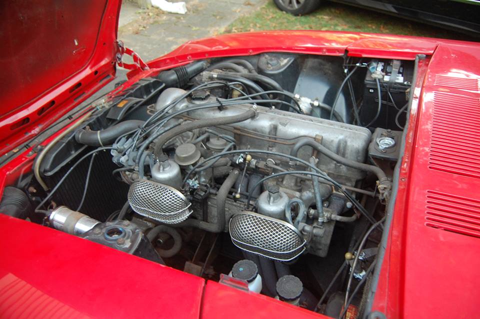

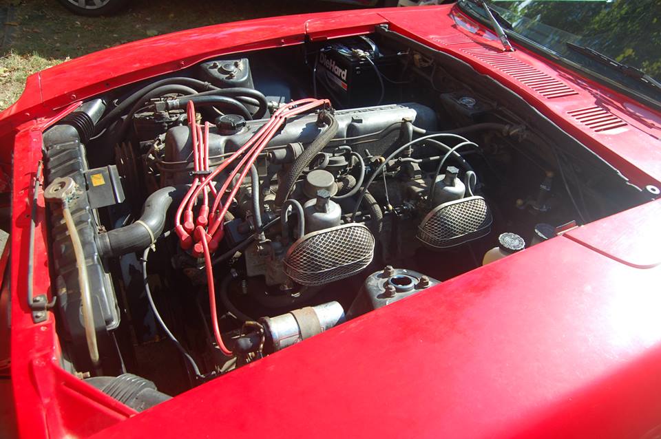

When I found the car on Craigslist and for the following couple of months, this is a little of what I had to go off of:

Time to start learning about Zs. The part you removed and called a power steering pump was most likely the SMOG pump - unless you took off the alternator or an A/C compressor. Get a Haynes manual for the Z. It seems like you may be in over your head with your new 42 year old car.

I do have a shop manual, and was the smog pump belt driven?
It's under the front air filter in this shot:
under the coil here:
Edit: It's definitely not the A/C compressor or alternator. Those are on the other side. You still solved one of the questions that had me scratching my head. (see below) Thanks.

The Factory Service Manual (FSM) calls it an air pump. The drawing is of high quality.
I'll have to take a look. I'll be the first to admit I get lost rather easily with older cars, I didn't have my '76 Celica up here long enough to really get into it... nor do I think it had any smog equipment on it when I got it. That started in '69 right? Kind of hard to tell when it's not connected to anything I guess. I did find it rather odd that it seemed like there were no provisions for lines to go into the rack, although I'd assumed someone must have swapped in a manual rack. Wouldn't be the first time anyone had swapped racks. Oh well. So that just means it's completely useless to me then.
