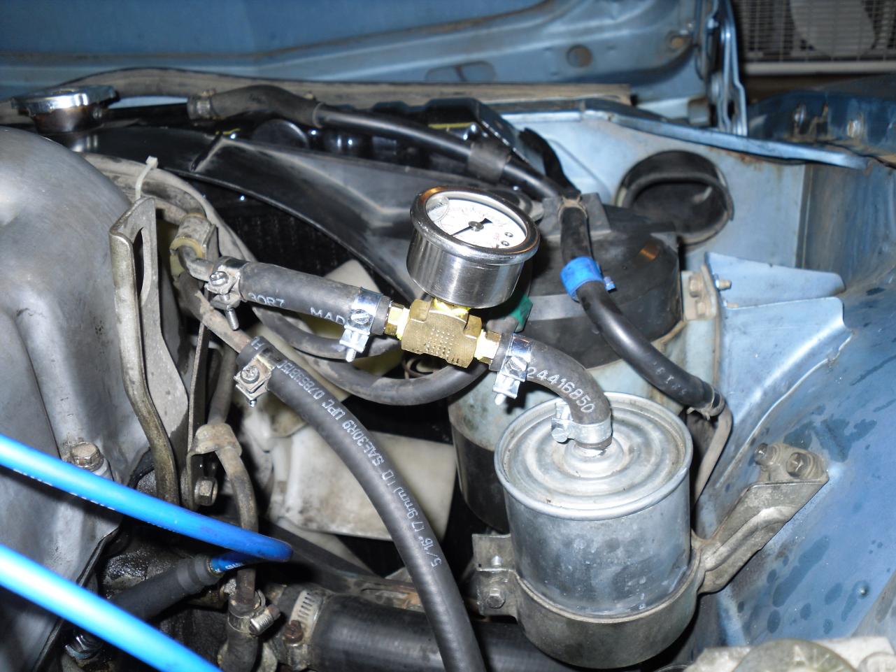

November 17, 201311 yr Author comment_436251 I know that there is a post somewhere on this but could someone please give me some direction on hooking up a pressure gauge so that I can monitor my fuel pressure. Also, what should the pressure be.I think this should probably be the first step. I just that I would also look at adding the pot incase it is an issue with the car heating up a causing a problem with fuel mixture but maybe I should see the pressure issue first.Thanks. Link to comment https://www.classiczcars.com/forums/topic/47963-sorry-to-be-redundent-help/?&page=2#findComment-436251 Share on other sites More sharing options...
November 17, 201311 yr comment_436259 I went to the hardware store and bought a cheap ($10?) generic pressure gauge (for water?), a brass, 1/8" FPT "T" fitting, and 2 1/8" MPT nipples/barbs. If you imagine the "T" standing upright, like the letter, the two nipples went on the bottom and left. The gauge screwed into the right. Then I stood the T on its side with the gauge pointed up. I hooked the nipple pointing down to the outlet of the fuel filter with a very short hose. I hooked the nipple pointing horizontally to the fuel rail, using a slightly longer hose. The pressure gauge has lived under my hood ever since, ready for whenever I might need it. It's like an umbrella, I suppose, in that it insures I will never have fuel pressure problems ever again. For a temporary test-drive setup, just put a "T" in the line between fuel filter and fuel rail, and run the third leg to a long hose tied to your windshield wiper. Make sure the hose is filled with fuel, and not air, or your fuel pressure regulation will get rather sloppy. Link to comment https://www.classiczcars.com/forums/topic/47963-sorry-to-be-redundent-help/?&page=2#findComment-436259 Share on other sites More sharing options...
November 17, 201311 yr comment_436265 I had an older picture from when I was doing what you're doing. I think I ended up running it off the fuel rail somewhere around the injectors, to the windshield wiper. 5/16" stuff is what you need but not necessarily EFI rated for the long hose to the wiper, it's expensive but you'll always be able to use it if you do buy that type. It seems like I used a worm clamp around the base of the gauge, it's 1/4", to hold the hose to the gauge on that end. If it starts leaking you can see it real good because it's zip tied to your wiper blade . Lowes would have a gauge somewhere, air compressor area or maybe plumbing, anything works for a short test. Pressure will vary but somewhere around 30psi is what you want. Hope this helps. Thanks again Fastwoman, couldn't done it without your help. After a cup of coffe I can honestly say the volume knob or potentometer ran inside while you drive is easier than hooking up a fuel gauge to the wiper. But I'm not trying to add to your worries, a fuel gauge is a must if you've got problems. Edited November 17, 201311 yr by siteunseen Link to comment https://www.classiczcars.com/forums/topic/47963-sorry-to-be-redundent-help/?&page=2#findComment-436265 Share on other sites More sharing options...
