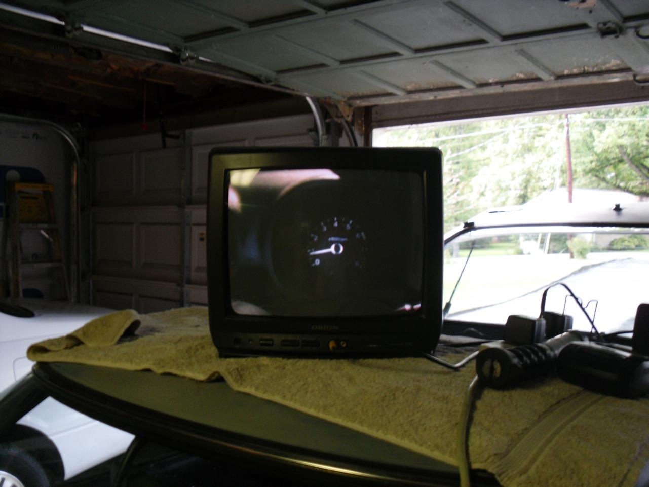

When I was trying to figure out my mid range stumble I thought it was the TPS at first, turned out to be the coolant temp tweak fixed it. If you pop the cover off and watch those vanes while working the throttle rod you can see if its making contact when it should and coming off the contacts when it should. I pointed a camera at my tach and put the monitor on the roof when I did mine. Maybe you could get someone to sit in your car and hold it at the right RPM's?
