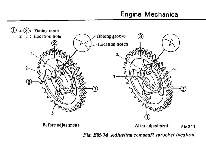

aligning the notch on the timing chain sprocket with the groove in the cam plate
I have read about this in my ancient Chilton's manual, and I cannot make sense of it (although I'm sure it's old hat to you guys..). The last time I had the valve cover off I spent 10 minutes with a flashlight looking for the groove, or even just trying to understand what the "cam plate" is.. and I was mystified. Any explanation or photos would be appreciated.

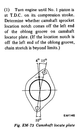

The procedure is described in the FSM, Engine Mechanical chapter, about pages 18-20. Any 280Z FSM should work. I've found that Nissan changed the shape of the notch to a square groove for the ZX engines so you might look for that also. It's on the back of the timing chain sprocket, right above its hub or center, right in front of the camshaft retaining plate. The oblong groove is stamped or engraved in the plate. I attached a picture of the plate with the notch (it's right below the "4") and the illustration of what to look for. It's something that's easy to do and will confirm proper orientation of many different engine components, all in one shot.
Just keep at it, you will get it. Like I said, understanding the valve timing and ignition is the right to passage with the L motors.

If you have trouble confirming the "groove - notch" relationship on any L series motor, it will cause all kinds of weird stuff, and the thing is you may not be aware of any mis-setting if you have certain parts like a cam sprocket that doesn't have a "notch" which makes it highly difficult to see the "groove"--so basically it SHOULD look like that picture or close to it, otherwise you may have a deeper problem
