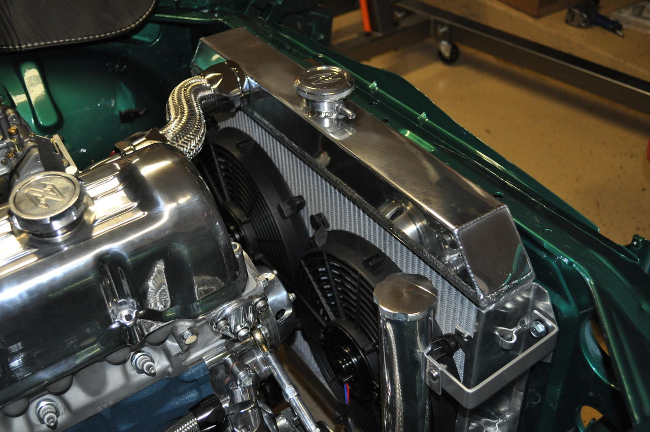

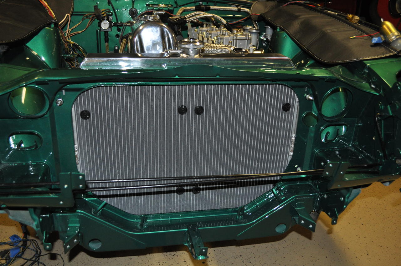

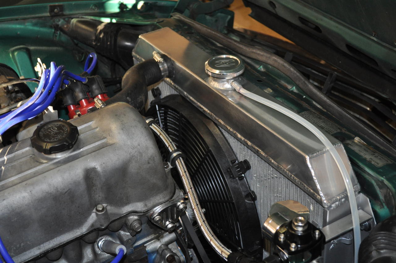

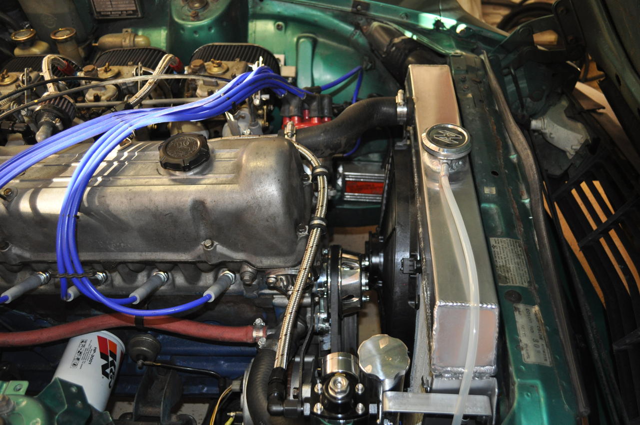

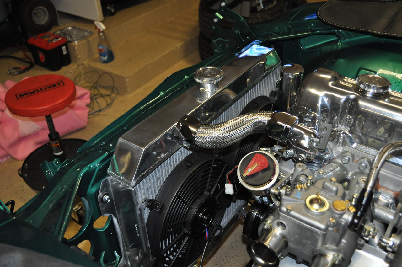

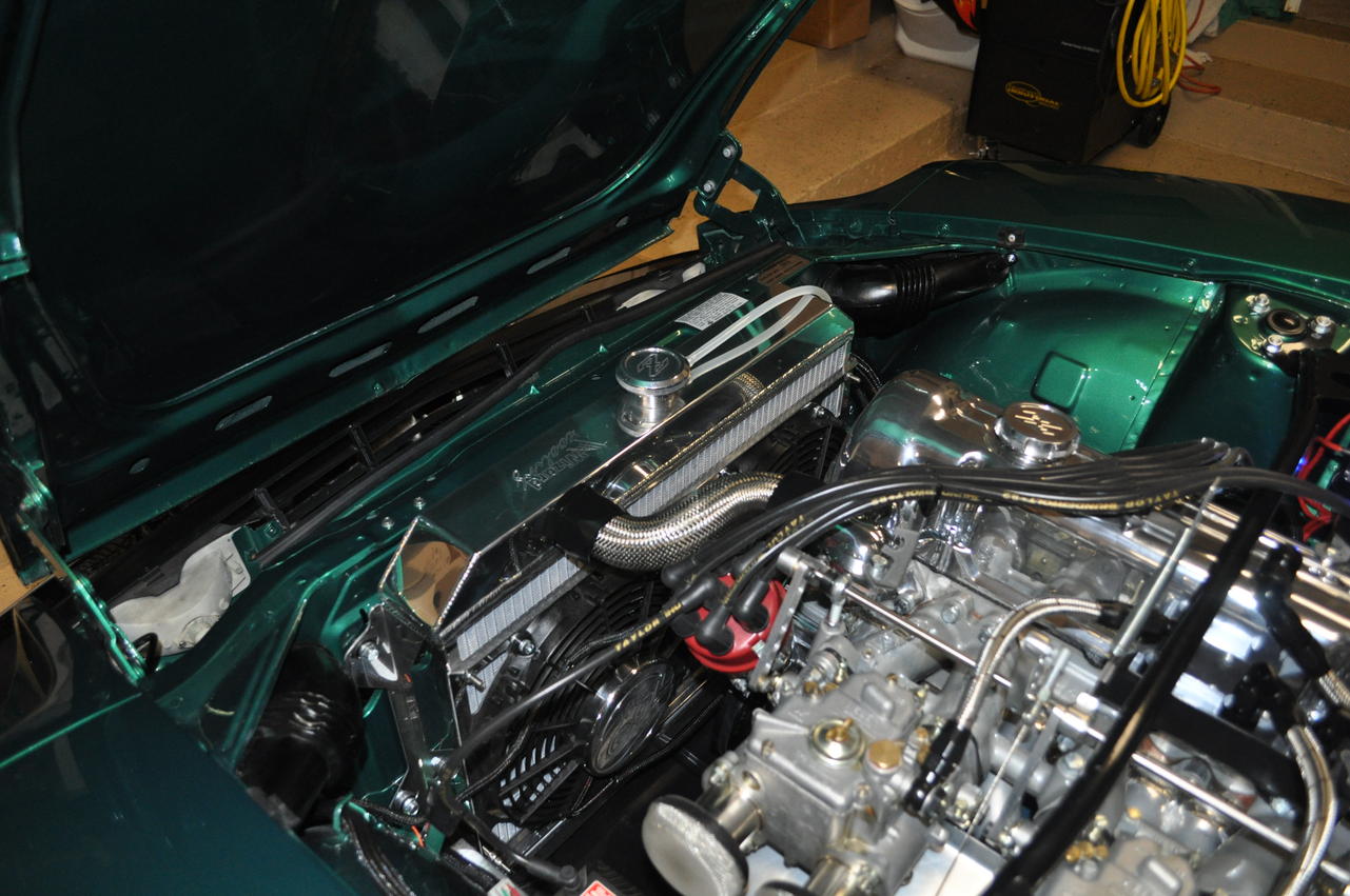

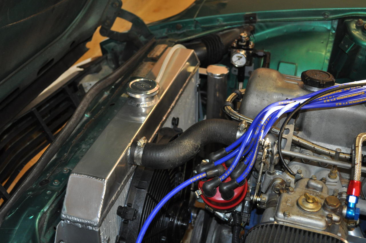

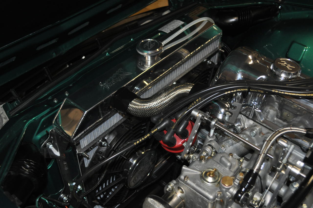

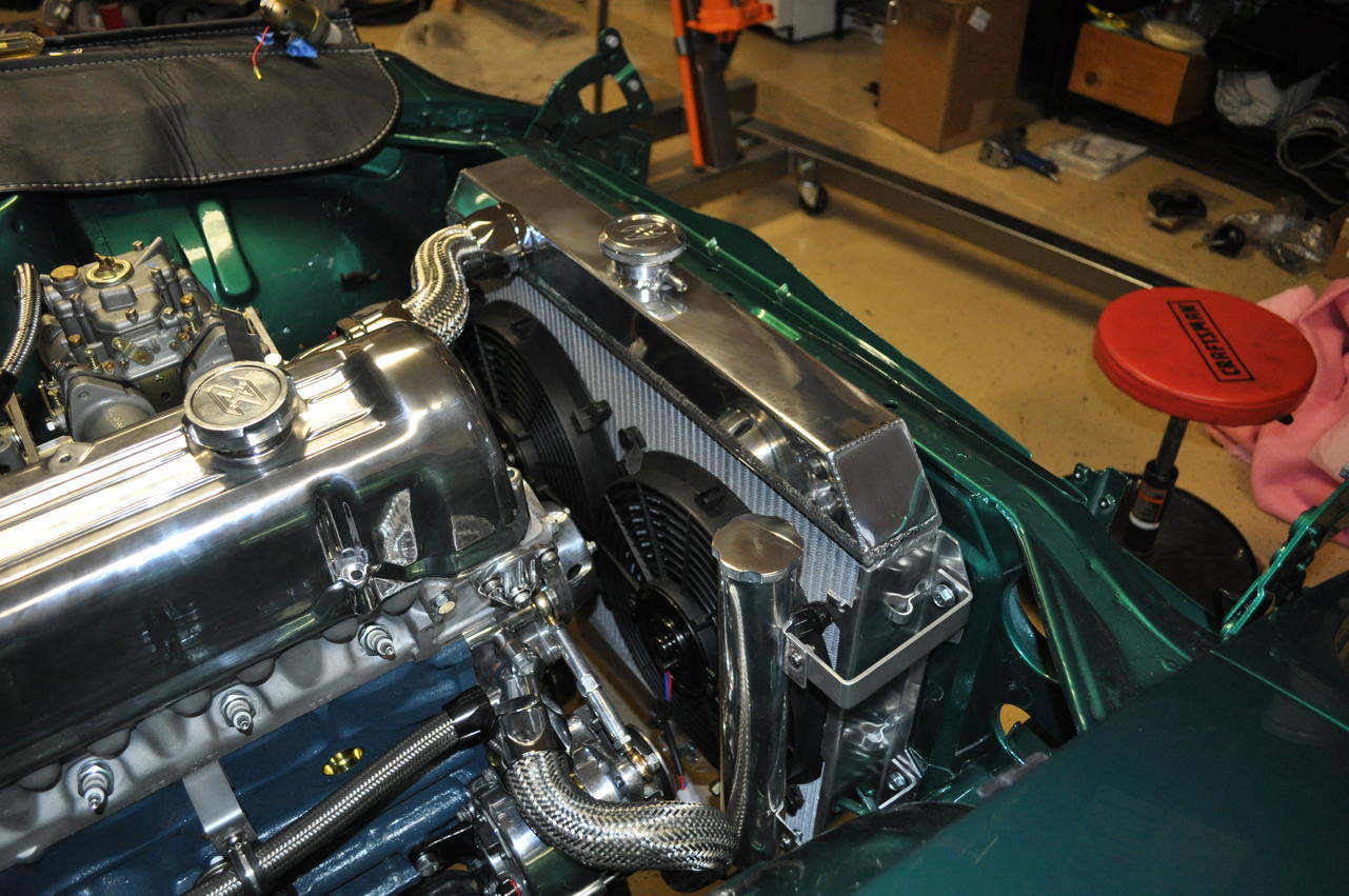

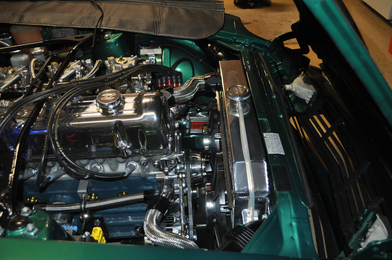

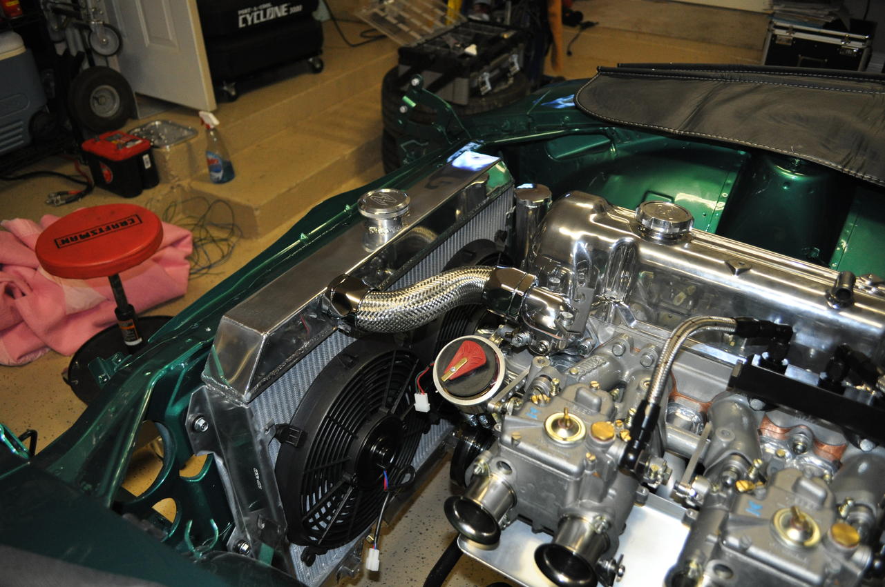

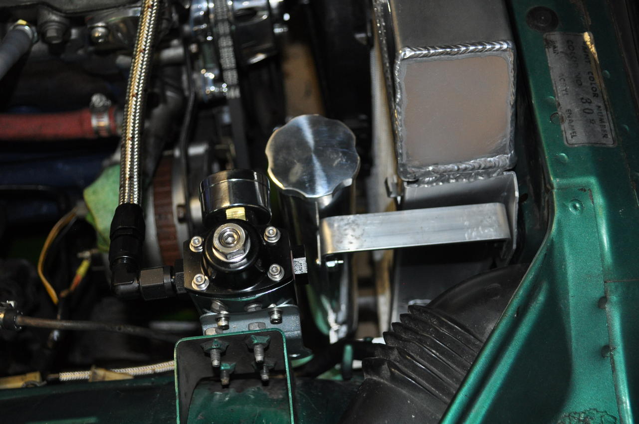

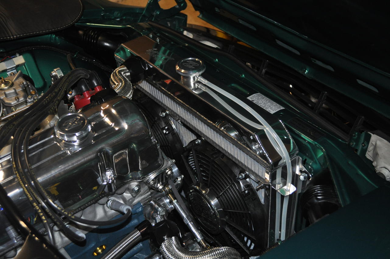

December 6, 201311 yr comment_437522 So I've received a number of requests for some pictures, so here goes. First some from the phase 1 attempt. Pay particular attention to the welds as well as the small brackets down the passenger side of the radiator, which I figured was to hold an overflow tube in place. Unfortunately I do not have a picture of the controller that I used, but I believe that it was from Painless Performance. Worked well and had an adjustable turn on control, but just didn't like the way the temp sensor attached through the fins of the radiator. OK. Next ones are from phase 2. I made this change when I was in the middle of an engine / body overhaul so it was a good time to do it. This one was a polished Champion, but I also believe that both Champion as well as American Eagle (first phase) are from the same company and are all made in Asia. This one has a slightly better build quality and certainly the polish makes it look better, but I can tell you for sure that the cooling capacity was no better than the phase one install. Also notice that I went to dual generic fans which I was hoping would cool better than the single 16" I used in phase 1 just given the amount of surface area covered, but no dice. I don't have a picture of the Dakota controller, but I ended up mounting it my glove box so the display would be accessible while in the car (for troubleshooting purposes and to keep it out of the heat of the engine bay). However, the last picture shows on the engine block where I removed a plug towards the back of the block near the firewall and replaced it with a temp sensor that is actually in the water jacket. This made for a nice clean install with no more probes through my radiator. On to phase 3 and Wizard. So as I mentioned earlier, I just stumbled on this company and actually found a part for a 280Z. Proceeded to call them and believe that I spoke to one of their engineers named Tom. He proceeded to tell me about why their radiators were superior to the cheaper ones from Asia and that they could easily do custom work as well, including polishing. When I explained some of the things I wanted change from my current setup, he even told me that the "tie wrap" mounting approach for fans actually voids the warranty on their radiators. The last picture is the final drawing (open it as PDF) I received from Wizard before they began work. It shows their attention to engineering detail as well as their focus on customer satisfaction. Notice the welds and how uniform they are. Notice the custom bracket they designed for my fans (and polished as well). Also notice the Spal fans (which are actually from Be Cool, but they only use fans from Spal). These things are like turbines when they turn on, noticeably more powerful than the generic ones these replaced. Finally, notice the brackets that I requested be attached down the side for my overflow tube. The unit is a piece of art and it cools like you can't believe. I can be in stopped traffic in 105 degree weather, will hear the fans kick in and will actually watch the temp come down. Anyway, judge for yourself. M Wodopian 260z(drawing) (3).pdf Hope this helps anyone looking at a cooling upgrade. If you have other questions, just let me know. Mike. Link to comment https://www.classiczcars.com/forums/topic/48088-cooling-fans/#findComment-437522 Share on other sites More sharing options...

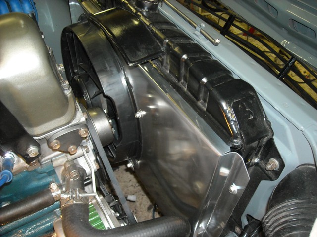

December 7, 201311 yr comment_437537 Did this mod to my 280ZX a couple years ago. Bought the shroud mounted fans on EBay. I lucked out and everything worked great. The fans are mounted on a stock (albeit heavy duty) radiator. Link to comment https://www.classiczcars.com/forums/topic/48088-cooling-fans/#findComment-437537 Share on other sites More sharing options...

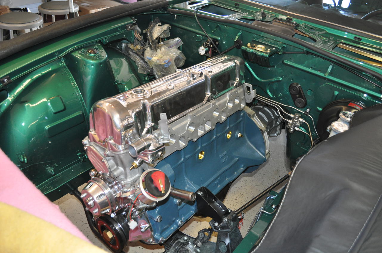

December 8, 201311 yr comment_437582 [ATTACH=CONFIG]68303[/ATTACH] Hope this helps anyone looking at a cooling upgrade. If you have other questions, just let me know.Mike.That is a might fine engine bay. Link to comment https://www.classiczcars.com/forums/topic/48088-cooling-fans/#findComment-437582 Share on other sites More sharing options...
December 8, 201311 yr comment_437624 Mine is a low dollar version, $10 for 14ga aluminum sheet, $20 for a A/C fan from a 1996 Ford Taurus (available after market for a very reasonable price if you want new) and a $110 for the Dakota controller that Mike mentioned. The Dakota unit cost more than I wanted to spend but as mentioned, you just can't beat it for adjustability. Mike, beautiful engine bay! Link to comment https://www.classiczcars.com/forums/topic/48088-cooling-fans/#findComment-437624 Share on other sites More sharing options...
