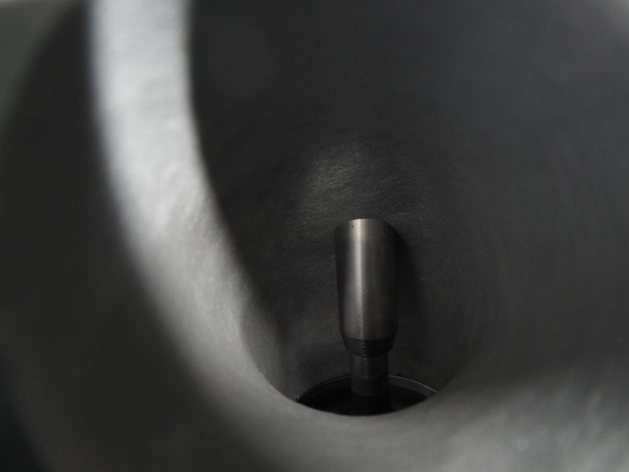

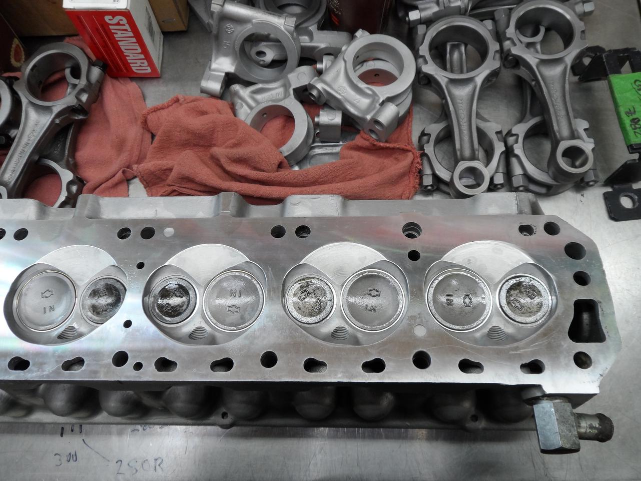

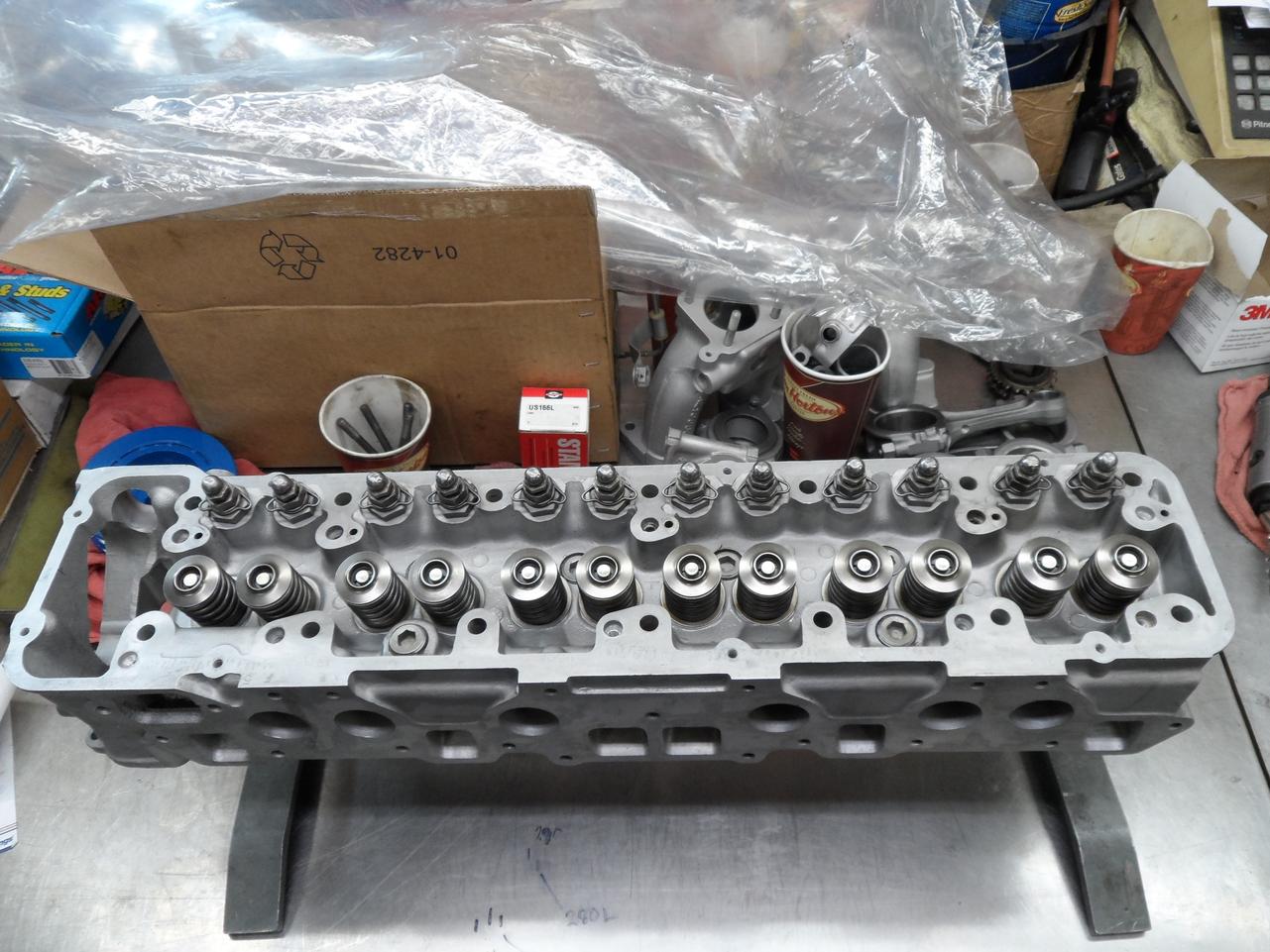

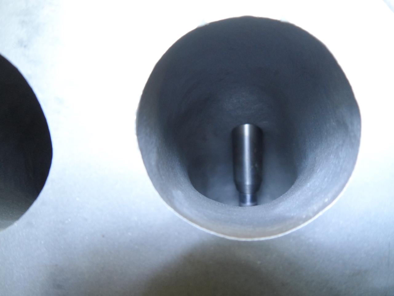

January 25, 201411 yr Author comment_440370 Some more pics.Valve seats are done, porting done, just waiting for the cam! Link to comment https://www.classiczcars.com/forums/topic/48099-off-to-ontario/?&page=2#findComment-440370 Share on other sites More sharing options...
January 26, 201411 yr comment_440372 Mark, your going with the stroked 2.7L right? Just looking at those valves, to my eye they look like the stock smaller valves.Maybe they have just cleaned everything but haven't started cutting yet. Link to comment https://www.classiczcars.com/forums/topic/48099-off-to-ontario/?&page=2#findComment-440372 Share on other sites More sharing options...

January 26, 201411 yr Author comment_440408 Hey Chris, I was thinking the same thing! I am going with the 2.7 l, but I have left the details to Mike. I know the head has it's new seats, so the valve size isn't changing at this point!Hey Hank, your car sounds like it's going to be amazing! I'd love to see some pics. I am trying to stay stock looking for the most part, I will have a Quaife posi as well, but in the original rear end with the four speed, eibach springs to lower the stance a bit, but staying with the 14 inch wheels. I am getting the Fujitsubo exhaust, that thing is just art! Mike also has a model correct KMH speedo for me ( no coloured warning bands) which is quite rare. We are aiming fo May long weekend for mine to be ready. I don't know Ian, is he a member here? Link to comment https://www.classiczcars.com/forums/topic/48099-off-to-ontario/?&page=2#findComment-440408 Share on other sites More sharing options...
January 26, 201411 yr comment_440447 Now that I think about it I remember reading about the E31 head and how well it breathes in stock form and that you would only notice the smaller valves at high rpms and wot. For a street car you are probably never going to notice. Maybe they didn't want to risk your original E31 head as they are getting harder to find in good condition.Ready in 3 months, wow. And if your are driving her back maybe we can get some the guys out from our local club,Ontario Z Car Club to give you a send off. Link to comment https://www.classiczcars.com/forums/topic/48099-off-to-ontario/?&page=2#findComment-440447 Share on other sites More sharing options...

January 27, 201411 yr Author comment_440493 Hey Guys, I do remember having this conversation with Mike now and he just confirmed it by email. The larger valves would be shrouded by the small combustion chamber without a lot of hours to open up each chamber. We are going with a 268 dg Comp Cam and with the street porting should flow very well and suit the Z Therapy carbs perfectly.Anything more extreme would need stiffer valve springs, making it harder on the valve train. I didn't want to sacrifice drive ability, or longevity of the engine.It would be great to meet you all in May, as we get closer to completion I will let you know my plans. The car is stuck at White Head for the moment, too much salt and slush on the road to get to the body shop!Mark Link to comment https://www.classiczcars.com/forums/topic/48099-off-to-ontario/?&page=2#findComment-440493 Share on other sites More sharing options...
