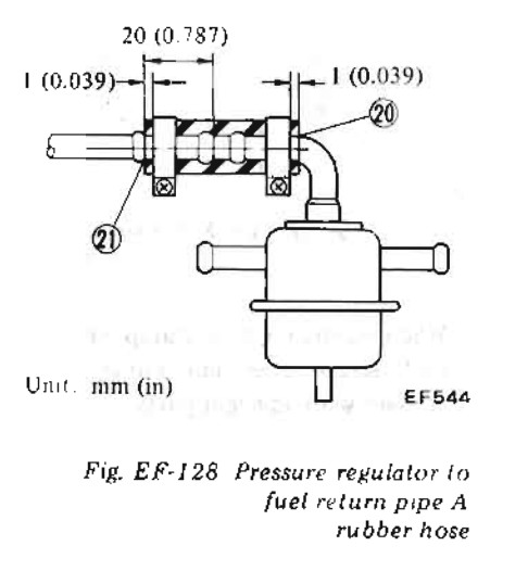

Yes, the FPR looks fine. Mine is a '78, so I didn't know about the extra inlet in the earlier models. (I'm afraid my '75 is but a distant memory from an earlier life.)

So I have the wrong FPR and it is improperly attached, the BPT line needs to be plugged, and I need to do ecu checks as per FSM/EFI bible, clean all electrical connections and recheck fuel pressure and timing...sounds like no football sunday!

The FPR is the "wrong" type for your car, but that doesn't mean it will not work. The extra inlet just needs to be plugged properly. The 5/16" (or 8mm) bolt can leak and cause a fire and your car wont survive.
IMO I would start from scratch and do all the FSM/Bibble checks again. That way you know were your at, you might just find something the mechanic missed and you will have a much better understanding of how it all works.
BTW That plugged inlet is screaming for a pressure gauge so you can check your fuel pressureLOL
