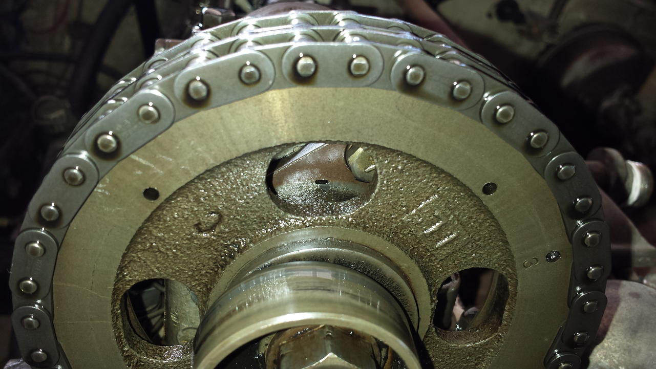

I got a replacement cam gear from madkaw and everything looks much better!
I made a hardwood tool using the instructions from my manual, here's a pic in case anyone on here ever needs that info:
I had trouble getting the sprocket back on there and I was really worried I didn't jam that tensioner well enough. I had to really pry the gear up with a screwdriver while pushing it onto the peg.
The '-' mark is on top of the V a bit. I may just move it to hole 2 later but I'll keep it as is for now. Next project is rebuilding the carbs with the kit I got from ztherapy. Thanks everyone for the help
