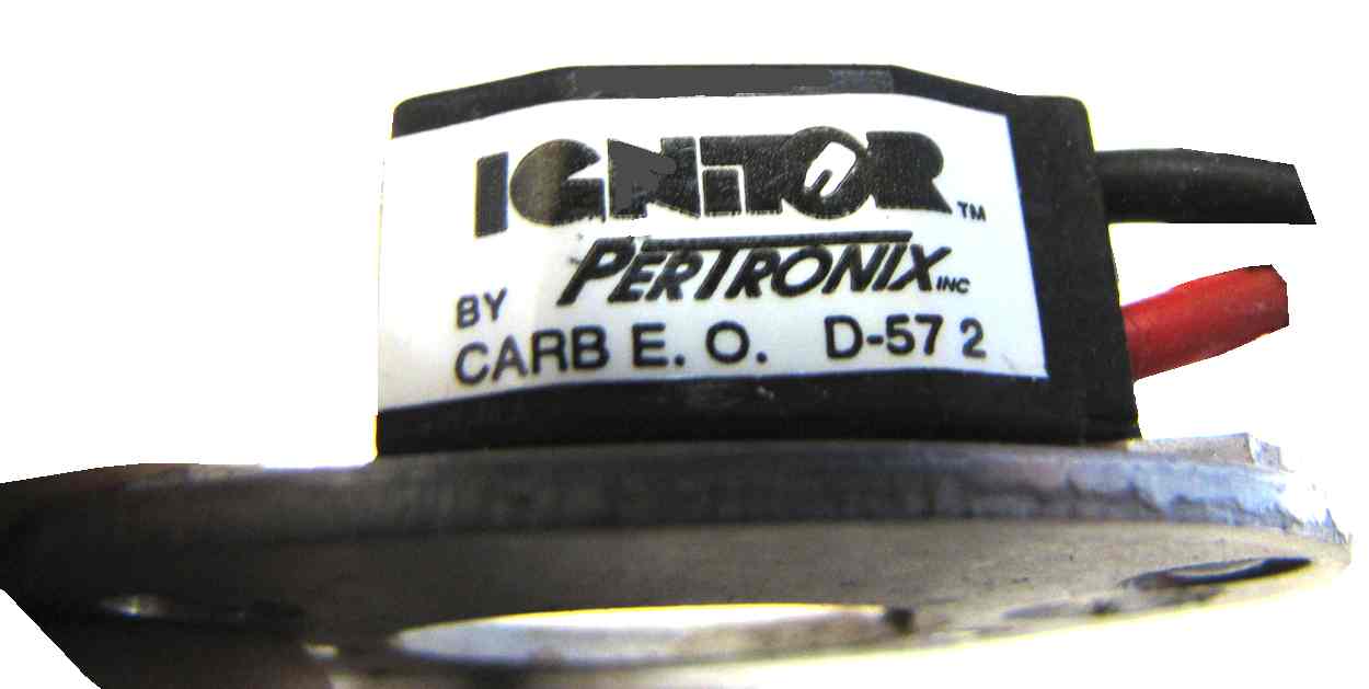

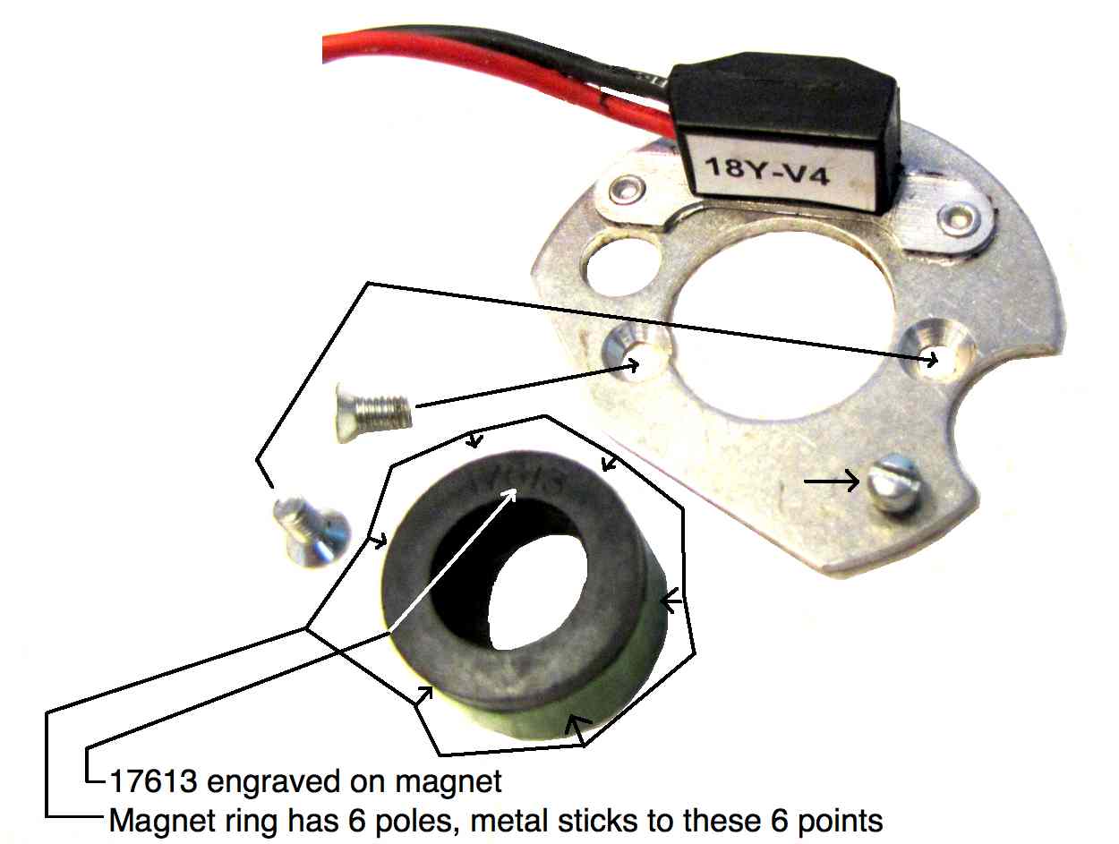

I have wondered how the Pertronix makes the dwell correct, maybe the electronics in the Pertronix figures that out or the magents are chosen to make that work with no adjustment? Here are pictures of the Pertronix I took out of my car in 2009 which I assume is their first model since it does not say ignitor II on it.
