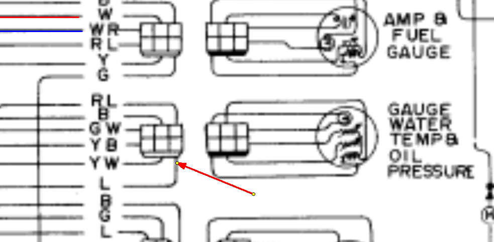

Going to piggy-back off this old thread rather than make a new one - the goal for me is to add a Voltmeter, (three gauge pod, replacing radio - I need to add a WBO2 in prep for the V6 conversion) not replace the stock ammeter though.
Trying to figure out which wire in the dash harness would make sense to tap into, to get an accurate charging voltage value. Something from the Voltage regulator would seem to make sense, however I have a hard time cross-referencing these old line diagrams against the schematics.
Any pointers?
I'm assuming the C-x connectors are the ones at the fuse/relay panel

Instead of cutting into an existing wire...
Use what's already in the dash. On the clock, there is constant power at the LW (blue/white) wire.
There is switched power at the L (blue) wire on the water temp/oil pressure gauge.
You would need to get two male shells (https://www.hi-1000ec.com/product/1133) and two female shells (https://www.hi-1000ec.com/product/1135) along with male pins (https://www.hi-1000ec.com/product/1662) and female pins (https://www.hi-1000ec.com/product/1663) to go in those shells. If the meter doesn't require constant 12VDC, you only need one male shell and one female shell, and you can take power from the blue wire.
You can then add a small harness between the dash harness and the gauge. Most of the wires will be straight through, but the wires where you need voltage would also split off to go to your new gauges.
The voltage regulator doesn't have any special properties that would give you a better signal than the two wires I pointed out. As long as the wiring isn't corroded or hacked up, what I pointed out should be fine.

Reviewing your idea - I'm not sure adding a (relatively) bulky bridge harness behind the 3 pods make sense. The dash harness is so neat & tidy from the factory, I'm loath to mess with it's layout 🙂
Those wires feed in via one of the C connectors, so it would seem to make more sense to tap or bridge into the harness before it enters the dash. The gauges I'm adding are in the console, not in the dash. I'll look for where the switched blue wire is located in the C connectors, the Voltmeter does not use a constant feed like the Ammeter.

If I'm understanding correctly, you want to put a voltmeter in the console, and you want a switched voltage signal to connect it to? If that's the case, then you could just tie into the blue wire that powers the radio. It's switched, and it's already in the console harness. If all your connectors are clean, it "should" give you an accurate reading of system voltage.
Oh, and BTW, the color wiring diagram you posted above is for the 77. Many (most) systems of the 77 are very similar to the 75, but there may be some differences. I normally would start by looking at that 77 color diagram, but to be sure, you should also double check the old style 75 diagram out of the FSM. Especially wire colors, etc.
