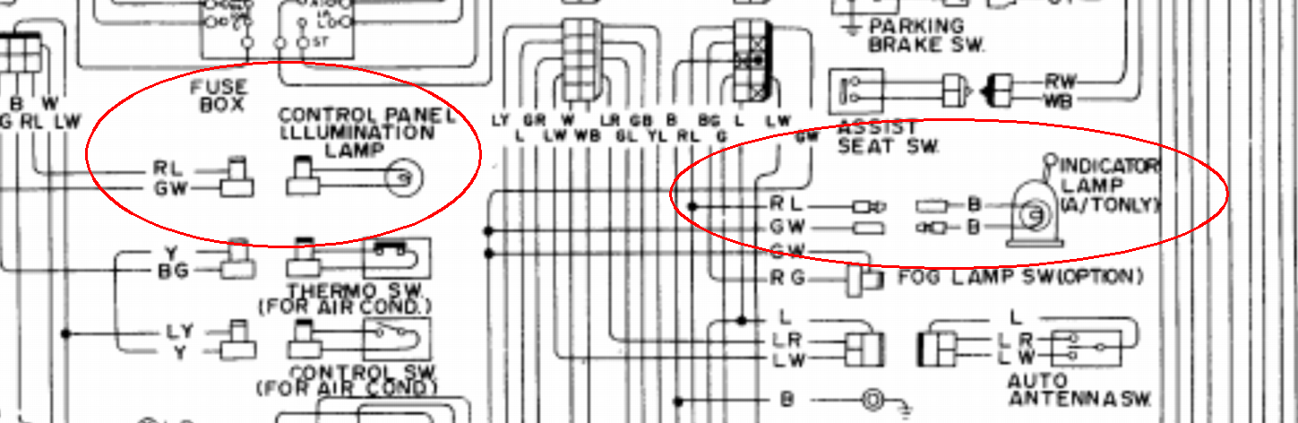

August 28, 20231 yr comment_656409 Yup, that color pair of red/blue and green/white are used pretty much universally throughout the dash and console as illumination lamp power. The red/blue becomes hot when the headlight switch is turned to the first position, and the green/white is pulled to ground through the brightness control knob pot. The wires you found there could be for the A/T gear lever position illumination and/or for the ash try illumination bulb. Don't remember offhand if they had that yet in 75. In any event, they are dash/console illumination. Link to comment https://www.classiczcars.com/forums/topic/48240-changing-an-amp-gauge-for-a-volt-gauge/?&page=2#findComment-656409 Share on other sites More sharing options...
August 28, 20231 yr comment_656410 Actually, taking a closer look at your pics, it looks like the white two position connector includes a red/GREEN, not red/blue. And if that's the case, then the wiring diagram indicates it was for the fog lamp switch. Optional for other countries, I think. Link to comment https://www.classiczcars.com/forums/topic/48240-changing-an-amp-gauge-for-a-volt-gauge/?&page=2#findComment-656410 Share on other sites More sharing options...
August 29, 20231 yr comment_656427 12 hours ago, SteveJ said: If you're looking for a switched source that isn't going through a relay, that would be the B/W (On and Start) or L/R (Acc and On). Neither has terminations near the center console. You could get a set of male and female 6 pin 6.3 mm connectors from Vintage Connections and get the power from the back of the switch. I would advise fusing it as close to that connector as possible. Thanks Steve - as far as I can tell, everything has to come through the Cx connectors. I would pull from there before adding load to the ignition switch. I have a good supply of 6.3mm crimp terminals & housings - both Volvo and Fiat used them back in the day 🙂 My main issue is the Nissan wiring diagrams make zero sense to me - I can't read the connector pinouts for the life of me. I'm assuming what's shown is either side of any given connector - C-2 in this case. Can't tell which side is body & which is harness. I'm used to diagrams that indicate the pin numbering - since this is 14pole - the diagram (for Volvo for instance) would indicate 1-14, so it would be easier to negotiate the diagram & corresponding harness wires/colors. It's gonna take a while to get used to these. Edited August 29, 20231 yr by HusseinHolland Link to comment https://www.classiczcars.com/forums/topic/48240-changing-an-amp-gauge-for-a-volt-gauge/?&page=2#findComment-656427 Share on other sites More sharing options...
August 29, 20231 yr comment_656428 11 hours ago, Captain Obvious said: Actually, taking a closer look at your pics, it looks like the white two position connector includes a red/GREEN, not red/blue. And if that's the case, then the wiring diagram indicates it was for the fog lamp switch. Optional for other countries, I think. interesting - there are wires taped up in the front crossmember /valance harness, I've not examined them, but presumably those would be for fog lamps then. I don't see any mention of them in the 75 FSM though. Another thing I've found - the harness & bulb holder I've circled seems to be for the low Fuel indicator lamp (yellow/blue , blue) = which I don't have. I'm assuming it was a small square lamp in the console below the radio, but that's where the AC thermostat was installed, so I guess they simply discarded the holder 😞 Link to comment https://www.classiczcars.com/forums/topic/48240-changing-an-amp-gauge-for-a-volt-gauge/?&page=2#findComment-656428 Share on other sites More sharing options...
August 29, 20231 yr comment_656431 40 minutes ago, HusseinHolland said: My main issue is the Nissan wiring diagrams make zero sense to me - I can't read the connector pinouts for the life of me. I'm assuming what's shown is either side of any given connector Best way I could describe the connector mating: 1) Hold your two hands out in front of you, palms facing up. 2) Then bring your two palms together. That's how the connectors on the wiring diagrams mate. And as for which side is which... In general, things are laid out on the wiring diagrams like they are laid out in the car. So for the Cn connectors the half on the left is the engine bay side, and the half on the right is the passenger compartment side. Does any of that help at all? As an additional aid on this C-2, the "X" is an unused cavity in the connector shell. That should help show how the two sides go together "mirror like". For example, the G/L on the far left connects to the G/L on the far right. While the "X" on the left connects to the "X" on the right side. Link to comment https://www.classiczcars.com/forums/topic/48240-changing-an-amp-gauge-for-a-volt-gauge/?&page=2#findComment-656431 Share on other sites More sharing options...
