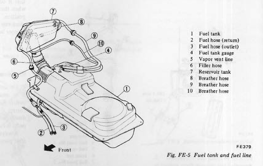

Only adding this so you can be sure about what lines you're looking at. Seems like the return line would be a straight shot back in to the tank. Maybe use an actual drill bit instead of a piece of speedo cable. Worth a shot before you cut a hole.
Thanks for the diagram. So it is line #2, return, but its actually a 90 degree hard line coming off the tank. Then if you follow the line inside the tank it runs down the bottom and to the other side where the internal filter is. So a drill bet won't help much with this.
The return line is the small one (2) 1/4" 6.35mm line. Line to the pump is (3) 5/16" 8mm line just to clear that up.
