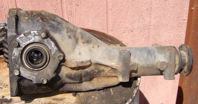

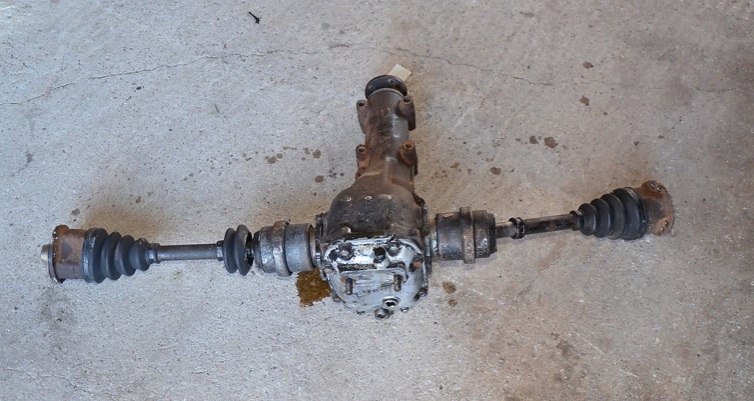

Here is a picture of the Maxima diff I just bought:

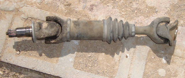

As you can see the U-joints are quite different from what the Z has. I just haven't worked on enough cars yet to know if this is going to be a lot of work. But it's gotta be doable.
For what it's worth, I do have a set of half-shafts sitting around from a 260Z parts car I got recently.
Edited by robox
Those are CV joint half-shafts and they're most likely too long to use, in addition to needing an adapter. The parts from the R180 in your car now might swap over, I believe. No idea on the details.

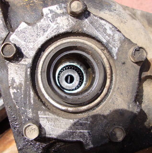

Anyhow, I did a bunch of reading of other older threads and learned that it's no big deal. Just gotta open the two diffs and swap a few parts, specifically the "threaded buttons" which permit the use of the OEM 240 halfshafts. No idea what those buttons are at this time, but I am sure I will know soon....

post-20299-14150827186372_thumb.jpgI just used the half shafts from the 3.36 and put them onto the 3.70-No issues in may case. While researching, I did see that some required removing a "button gear" inside the diff. If this is the case, I believe it was a circlip that you have to release from inside the housing, and then slide the shaft out. It was a couple years back, but it should be doable given the parts that you have.
If yours does not look like those above, I will look for the link that I had read in the past.
Let me know.

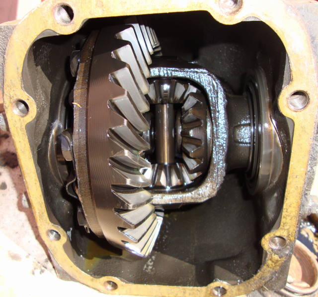

Well I received the Maxima differential. It's a good thing I popped off the rear cover to inspect the ring and pinion before I did anything else to it, because the ratio WAS NOT as advertised. It's a 3.54 (39:11). Now I have to send this heavy thing back on my own dime (I'm going to petition eBay to pay return shipping, we'll see how that goes).
