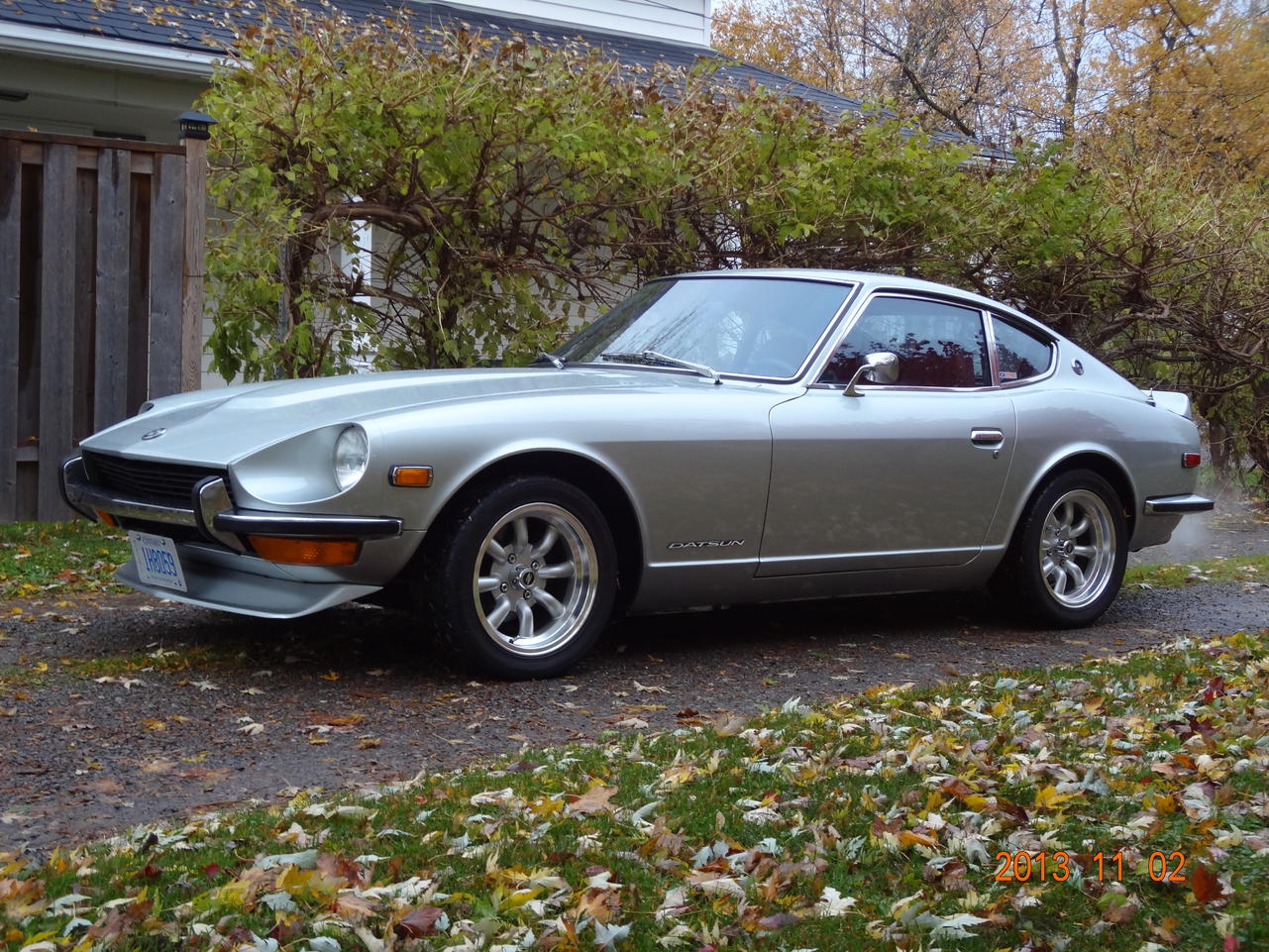

January 18, 201411 yr comment_439880 When we painted this a few years ago we based the paint on the original code. Base coat clear coat will never look like the original paint that was used.The colour is looks deeper due to the clear coat and the fact that we dropped a little extra coarse metallic in the paint for depth. Still it is close and is a great colour on a 240z. Casey Link to comment https://www.classiczcars.com/forums/topic/48336-901-silver-metallic-how-to-match-this-color/#findComment-439880 Share on other sites More sharing options...
January 18, 201411 yr Author comment_439885 Your ZED is exactly the look I am going for.. it's my understanding the paint used a few decades back can't even be purchased any more (due to EPA regulations) - not to mention that Datsun back in the 1970's probably didn't put a whole lot of effort into paint to increase profits <g>. Matching paint seems to be a science - I've had a WRX STi and a Dodge Challenger 392 repainted in the past couple of years - the STi was jacked up (they didn't match the silver perfectly - and the body/paint shop was a Big Three car dealer) and the 392 they sweated matching the paint for a week straight, as the computer's formula produced paint that wasn't a perfect match - they had to eventually produce small batches and then eyeball the color to match the rest of the car. Your car is stunning, and hopefully the effort being put into mine by a very meticulous professional that I stumbled onto here in town will make me proud <g>! When we painted this a few years ago we based the paint on the original code. Base coat clear coat will never look like the original paint that was used.The colour is looks deeper due to the clear coat and the fact that we dropped a little extra coarse metallic in the paint for depth.Still it is close and is a great colour on a 240z. Casey [ATTACH=CONFIG]69265[/ATTACH] Link to comment https://www.classiczcars.com/forums/topic/48336-901-silver-metallic-how-to-match-this-color/#findComment-439885 Share on other sites More sharing options...
