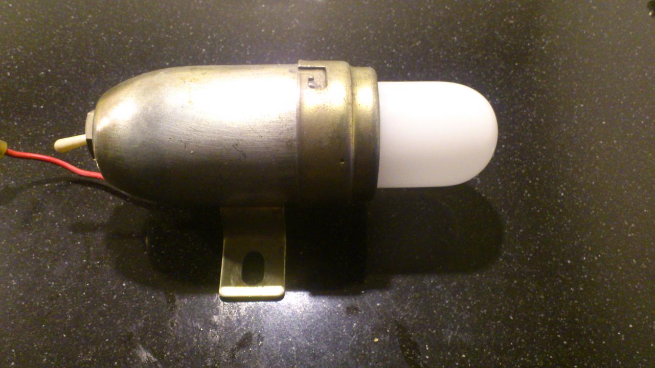

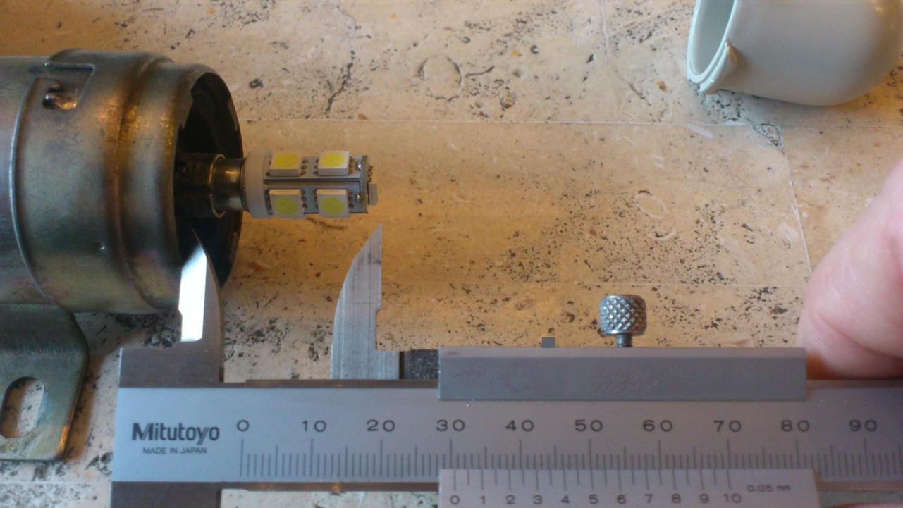

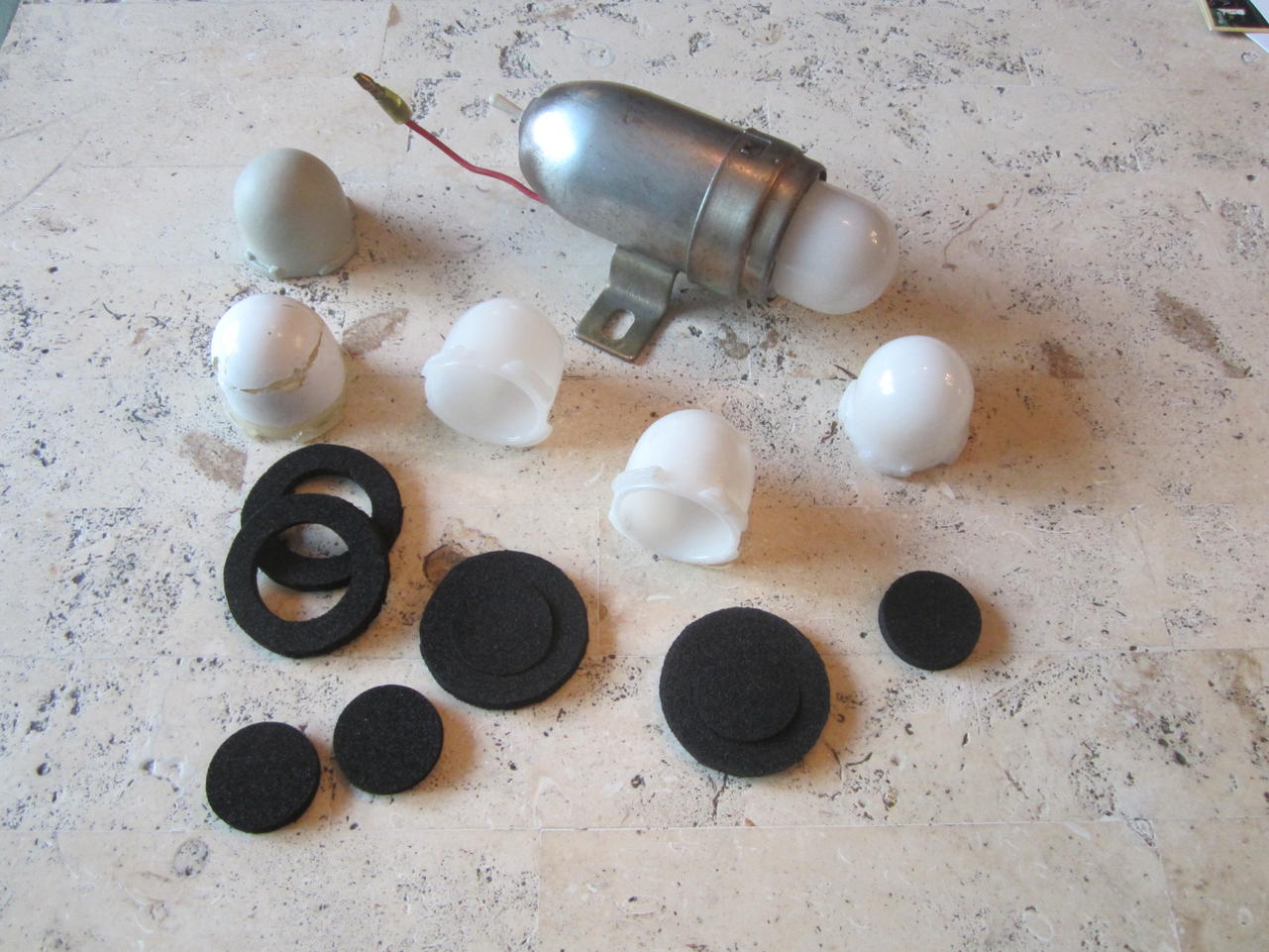

I ordered a replacement 9 SMD LED (BA9S) for my engine bay light thinking it would give more light than the bulb Im using now.

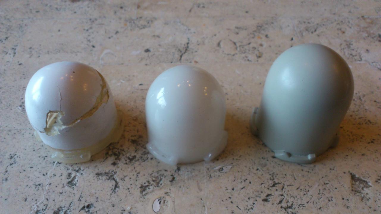

Only problem is the LED won't fit under the standard lens. Its too short.

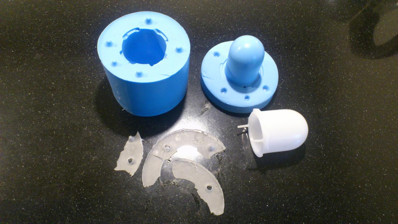

To get it to fit I made a 10mm longer lens out of two other ones I made and from that I made a mold for a new longer lens.
Now the LED fits and the end result looks like the original all be it a little longer.
Its a lot brighter than my old bulb and uses a lot less current. Im happy.

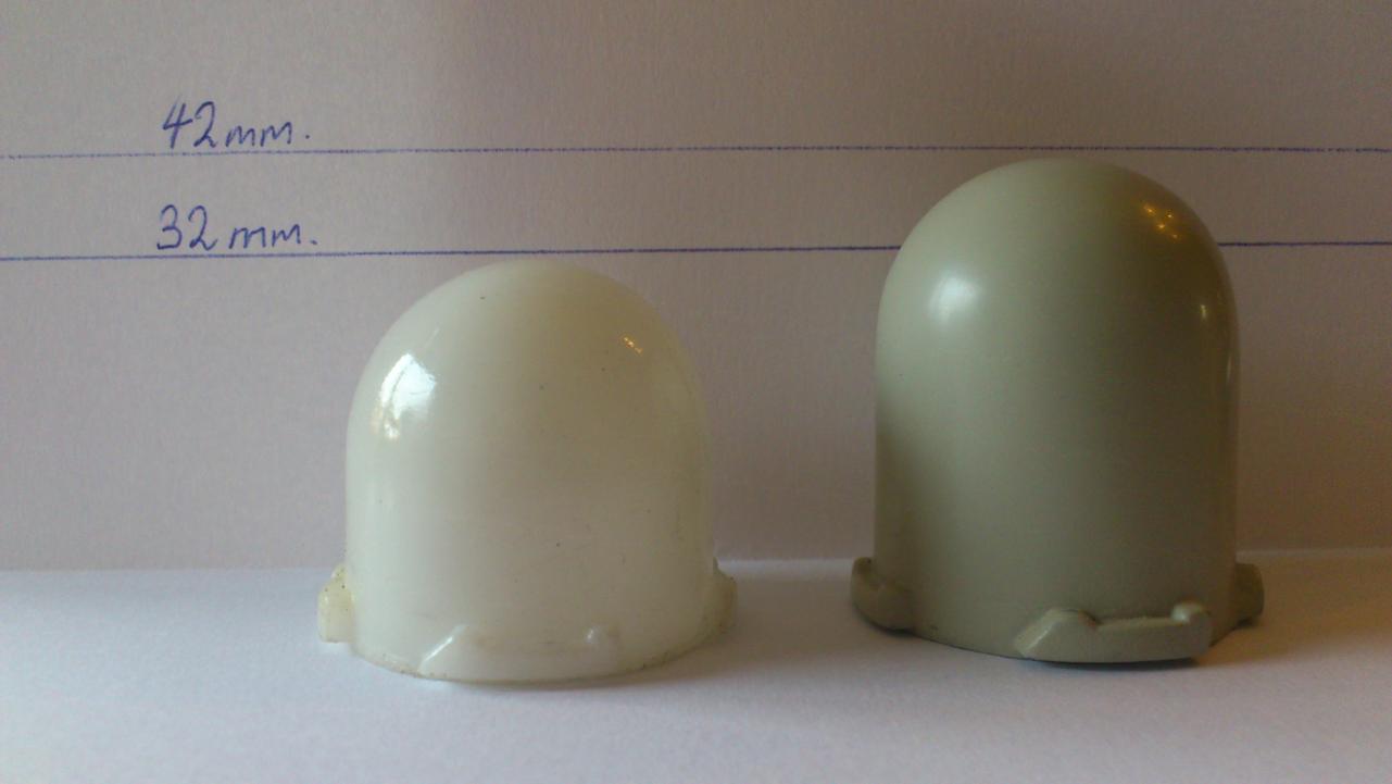

Yea, I thought it might of been the lens I made by copying an old one that was shorter, but the other spare original is also the same length and that one came from a completly different vehicle.
This longer one fits the LEDs I have and looks great. There might be other types available, but all I could find where all 39mm.
Chas
Chas
My guess then is that the 9 LED bulb I bought was a little shorter.
