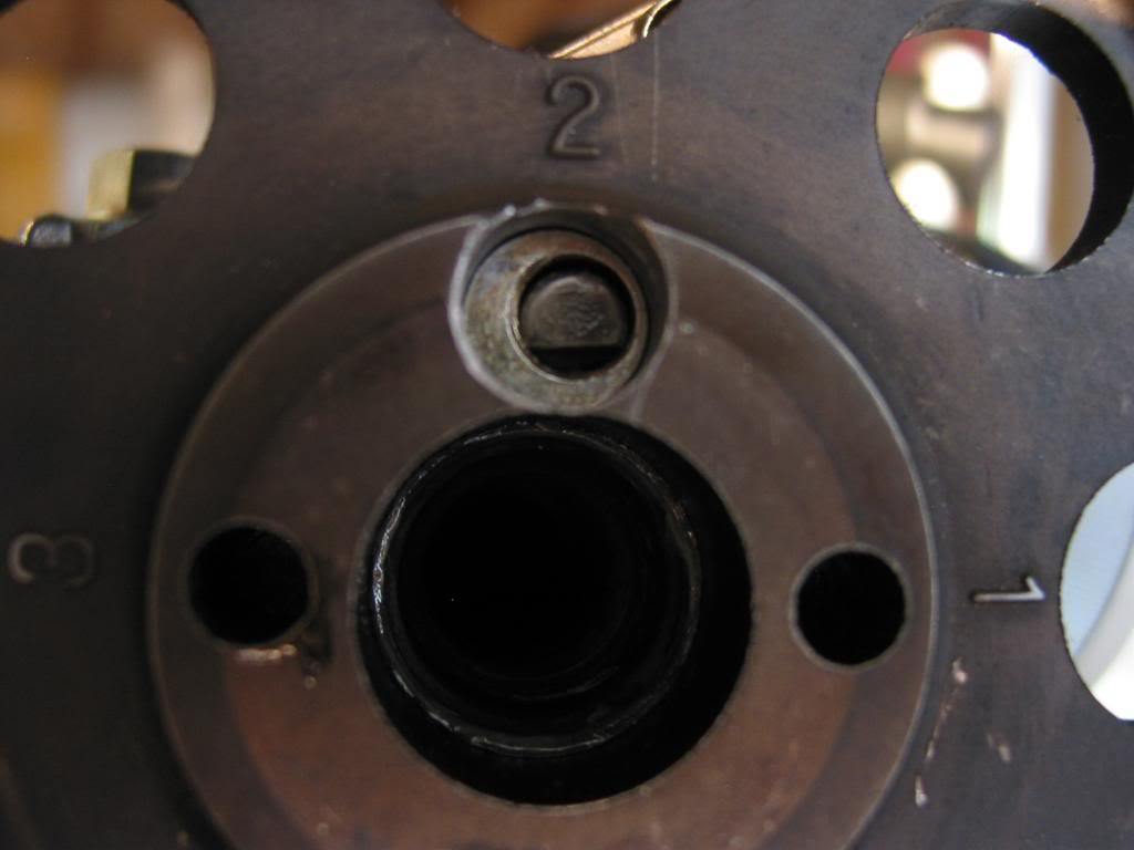

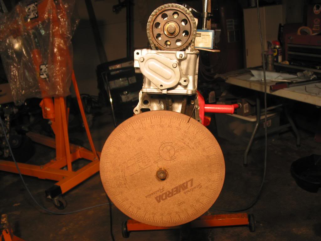

January 27, 201411 yr comment_440496 You don't have to use tower shims. My endurance racer P79 head was shaved 0.050" and I don't run shims. I get to the correct timing with the offset cam gear bushings as described in the "How To Modify..." book. Runs like a champ. Link to comment https://www.classiczcars.com/forums/topic/48401-bronze-valve-seats/?&page=4#findComment-440496 Share on other sites More sharing options...

January 27, 201411 yr comment_440499 You don't have to use tower shims. My endurance racer P79 head was shaved 0.050" and I don't run shims. I get to the correct timing with the offset cam gear bushings as described in the "How To Modify..." book. Runs like a champ.True. But if you go with a performance cam and you actually want to degree it, it will be MUCH easier having the geometry close. Shims are 60$ .P79 has a much bigger combustion chamber so .050 on it is not as much as a e-88 that already has small chambers. In the end- your head should be fine, but some homework will pay dividends Link to comment https://www.classiczcars.com/forums/topic/48401-bronze-valve-seats/?&page=4#findComment-440499 Share on other sites More sharing options...
January 27, 201411 yr comment_440504 Agreed Steve. Getting the timing spot on wasn't very hard with the offset bushings. Edited January 27, 201411 yr by Jeff G 78 Link to comment https://www.classiczcars.com/forums/topic/48401-bronze-valve-seats/?&page=4#findComment-440504 Share on other sites More sharing options...
