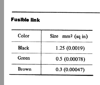

It looks like it comes with 1 100 amp fuse. From my research, the 77 car uses 3 red links & 1 black. Does this equate to 3 50 amp fuses & 1 80 amp to replace the links?

The fusible link versus amp rating topic pops up occasionally. Somewhere along the line, either Nissan made a mistake in their manuals or a translation error in color versus rating has occurred, or in what color Nissan was really referring to in their manuals. The cars were supposed to come with brown links, not read. And Brown is the smallest gauge, therefore the smallest rating. So if Green is 40, the Brown must be less than 40. Copied the page from the FSM.
Apologies to anyone who's tired of hearing this. My logical brain just can't let it go...
Edit - and just to make it more confusing, MSA now has a diagram for the links on their site. But they use a brown color to show where their red links go. They chickened out!
http://www.thezstore.com/page/TZS/PROD/12-4336
And just to round things out, the atlanticz site shows the red as 0.69^2, but the FSM's say 0.3^2. So are the MSA links 0.69 or 0.3? Regardless of color, it's a confusion.
http://www.atlanticz.ca/zclub/techtips/fusiblelinks/
