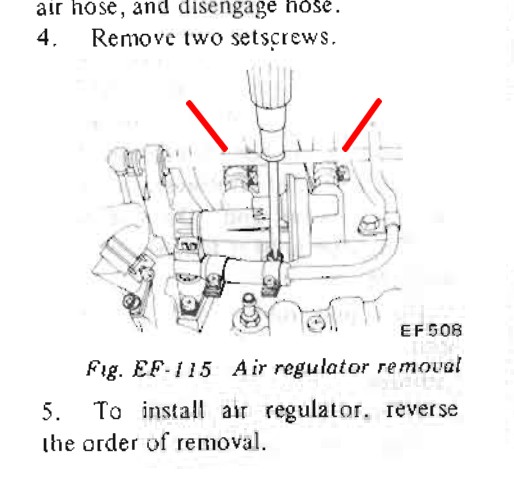

I can't find a specific reference to the heating block but I did find a picture. I added red lines to indicate the inlet and outlet coolant lines.

Zed. mine doesn't look like that all, the lines in your diagram don't show in my FSM at all.
