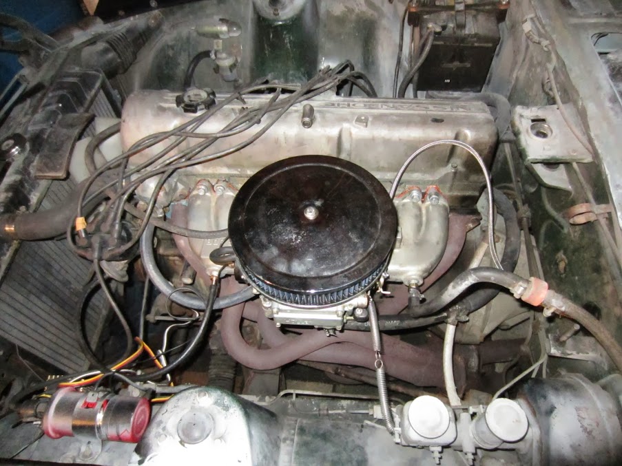

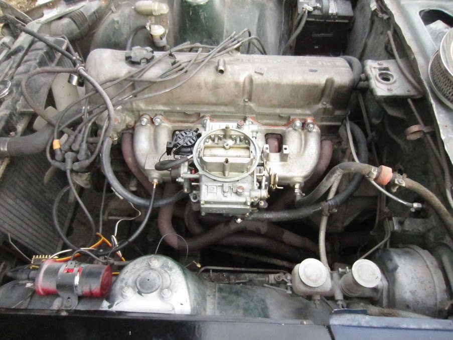

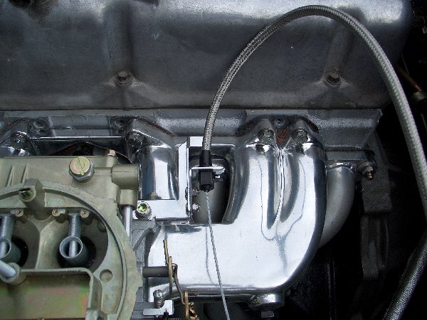

Ive had everything installed for a week or two and I think ive got the whole tuning thing down. Went from having to turn 2-3 screws on the SU's to 7+! Notice the sweet return spring setup!
Much easier to install with no balance tube in the way (I had to do it twice since I had to tighten the coolant fittings on the bottom and my header was in the way). Most difficult part was the throttle cable install. The BSR manifold has the throttle linkage posts which just got in the way of the recommended spectre install hardware so I had to cut that up.
The stupid black plastic piece that goes on the end of the sheath cracked as soon as I installed it and then I had to pull everything apart and bore out the plastic piece because it was preventing the cable from moving freely :finger:

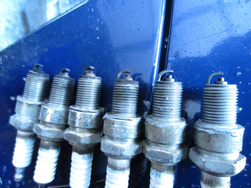

I love the setup :love: pulled the plugs and they were uneven and so dark!! :cry:
This explained my fuel economy and gave me some info about my mixture but it also happened to be the complete opposite of what people told me I would see, 3 and 4 were the leanest! Yesterday I cleaned the plugs, lowered the floats and also brought my timing down to 15 degrees from 20(so much for that supposed increase in fuel economy). Pulled the plugs again today and saw all the plugs were a light brown but 3 and 4 were a little richer than 1 and 6. Im hoping that by going to the FSM recommended 17 degrees (Not the random sources on the internet :stupid:) Ill have a nice even mixture across the board. 0-60 run will have to wait until there isnt as much snow on the ground and piled on the side of the road.
The only time the engine sees at the initial timing point is when the throttle is closed, assuming ported vacuum is used for the vacuum advance, and the centrifugal is stock and working properly. Otherwise, throttle open applies vacuum advance and increased RPM applies even more. Those two will determine how the engine runs when driving.
In short, make sure your advance mechanisms are working properly and they're what you want for mileage and power.
Zed Head, your post caused me to look up how my distributor actually works :). I read a couple places that advancing the timing a bit more could get me better fuel economy around town but I think it made it worse. This car has NEVER gotten very good gas mileage(compared to some of the numbers I see posted), I think the best ive ever gotten out of all the carb setups Ive tried was 22/15(shifting at 2k) with the ZTherapy carbs but I have no idea how much the cam/close ratio 5sp/3.90 affects it. Maybe I should take closer look at the distributor? Interested to see if the timing can really change the color of my plugs

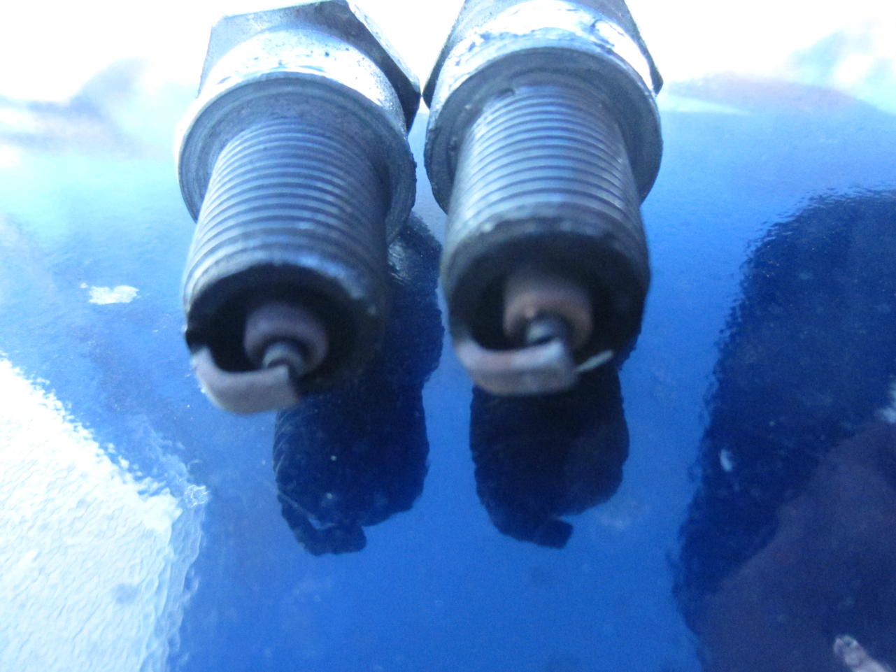

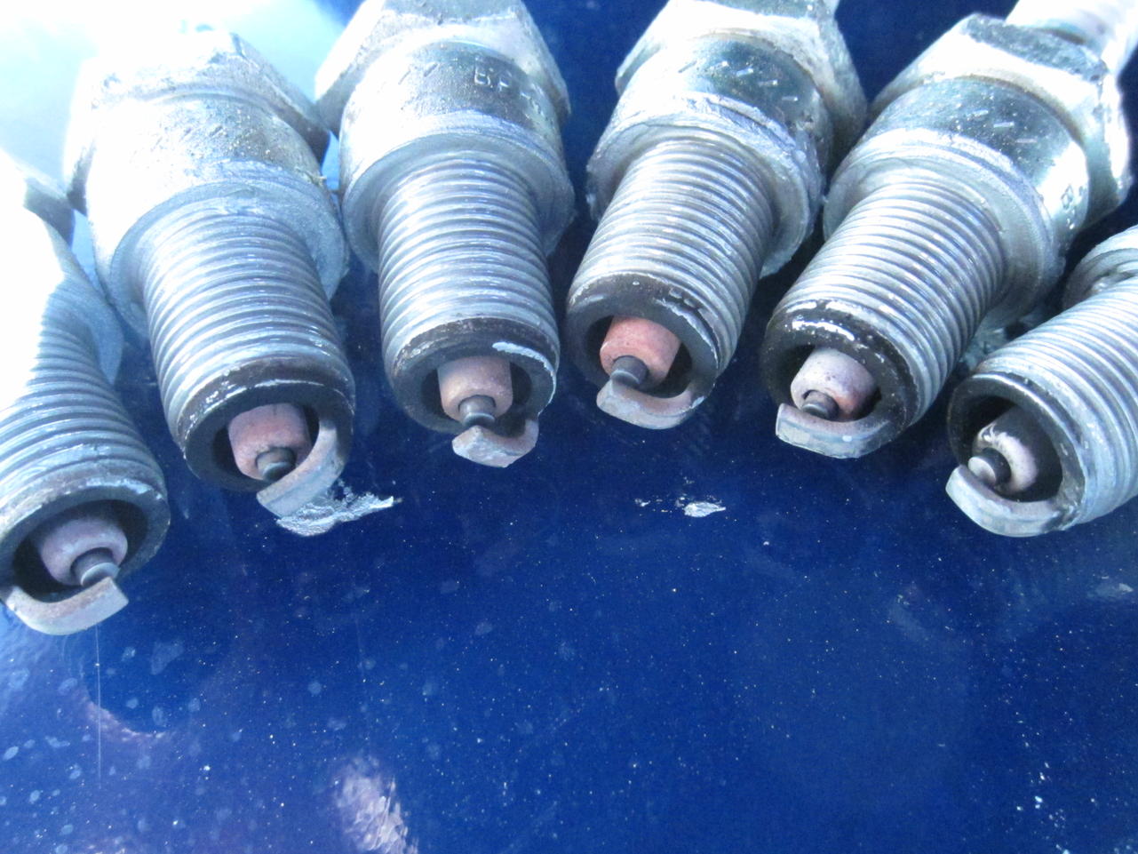

Took some shots of the plugs today at 17° initial timing. I just cleaned up both electrodes before I reinstalled them last time. The white/grey looking stuff is anti-seize
(especially on #6!) that managed to get on a few plugs but wouldnt wipe away entirely
Plugs 1 and 3
ClassicZCars you saw it here first. Ive managed to run a Holley lean! LOL

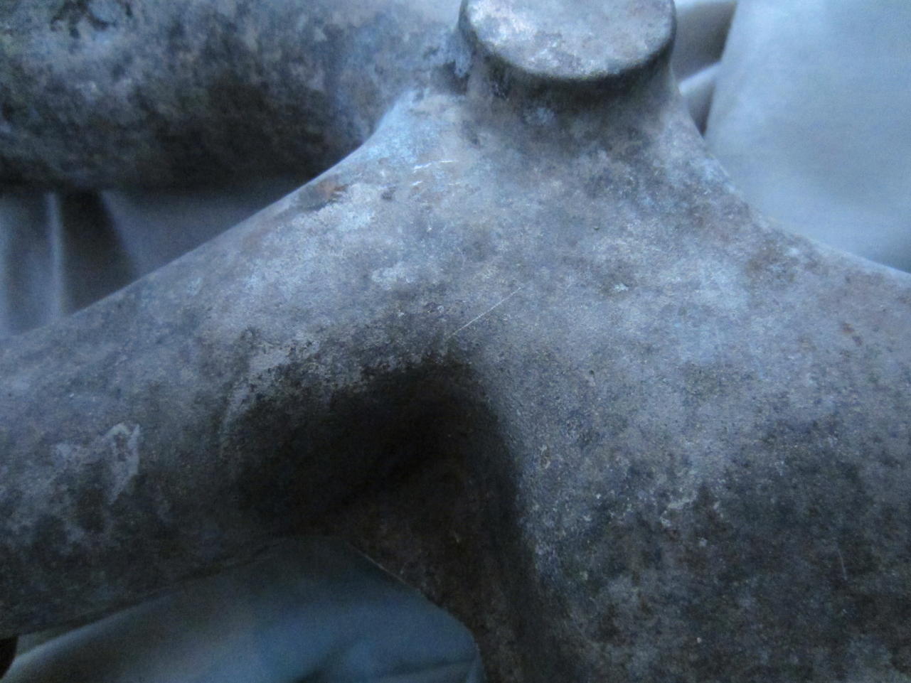

I personally would love to see your theoretical manifold design for the four barrel carb. I've done my own research and looked carefully at several manifolds for the L and other engines and if I had the time and money, would've created that manifold.

Its been a while since I updated! Regarding the manifold design, I emailed Dave @ AZC. The BSR has a lower divider, narrower runners, and those ribs before the #3 and #4 runners. Dave said "...The divider in plenum makes a dramatic improvement in low end response, I also opened up the runners for improved top end. Overall performance is excellent." So the AZC appears to be better than the BSR.
