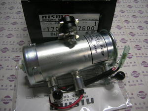

January 9, 20169 yr comment_484208 My early 260z had a fuel pump installed in the exact same location and it was powered by a wire run around the front of the vehicle and tapped off of the resistor next to the coil. My car had 2 fuel pumps that looked like this one, one at the tank and another in the engine bay: I bought a new carter fuel pump and placed it by the tank in the rear at the stock location. After messing with the electrical to power the pump on ignition on (instead of a few hundred RPM) I was able to keep the single, silent, cheap fuel pump and discard both giant loud ugly pumps. Link to comment https://www.classiczcars.com/forums/topic/48509-electric-fuel-pump-question/?&page=2#findComment-484208 Share on other sites More sharing options...
