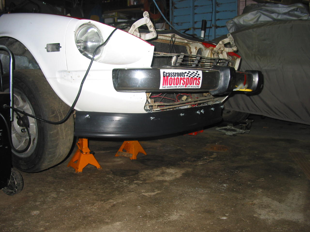

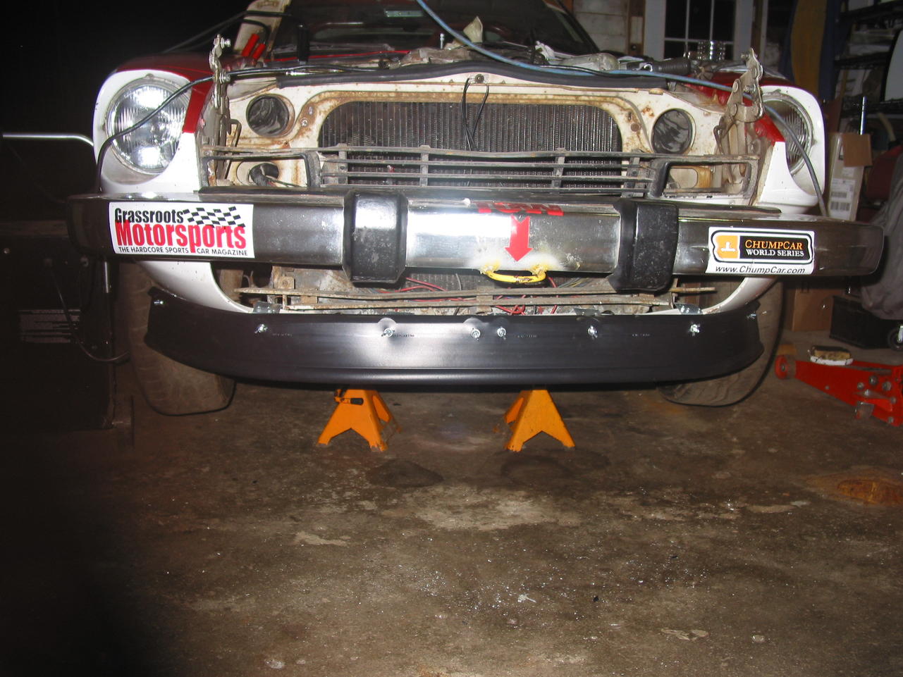

We kept the stock valence and added garden edging. It's held on with wing nuts, so it comes right off for loading/unloading. There are a series of L brackets with studs looking forward to attach the "airdam" to the valence. It works well and doesn't flex at speed. It comes off in less than a minute, looks pretty good and the cost was almost nothing.
Jeff, I love the garden edging idea. I have a whole yard full of that junk and I hate it... this is the perfect chance to recycle! Can you post close-up photos of how the L brackets and studs are placed... that would save us a lot of experimenting. Many thanks!
I don't have any pics with the plastic edging removed, but you might be able to see how the brackets are installed in these pics. They are simply sheet metal bent to the right angle and they are held on with screws (rivets would be better). You can see that the ones in the grille opening are attached to the top of the valence with the bracket looking down. The bolts go through the L brackets and have a nut to keep them tight. The plastic is then held on with washers and wing nuts. It isn't a work of art, but the whole thing was made in less than an hour. We bought a 20' roll of the edging and we made at least one spare so it could be replaced if it gets torn or wears down.
