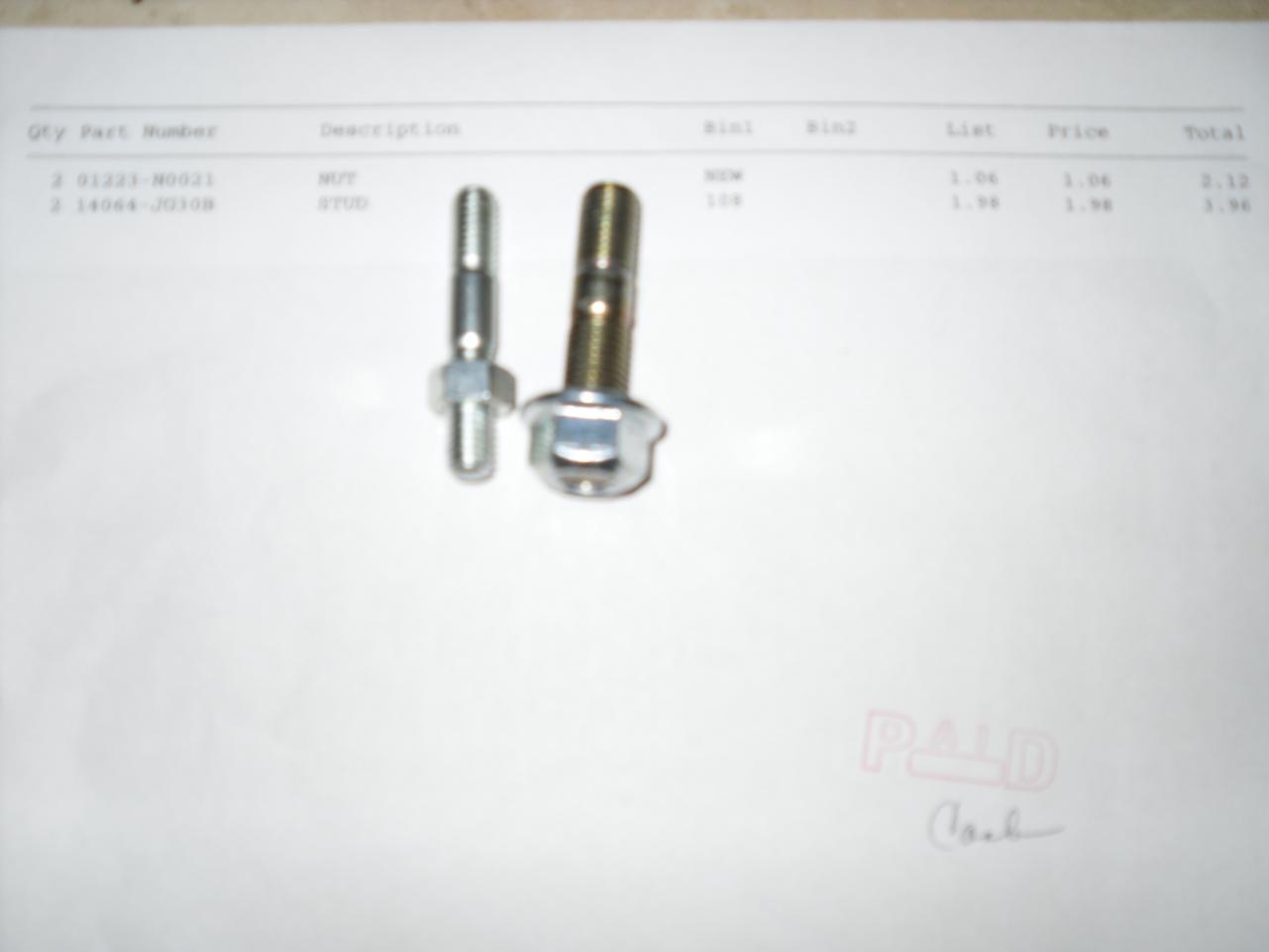

Theses are the ones I used on the ends because they break sooner, 2 I tapped out to the #10 size. They were for an 8 cylinder Nissan truck. The smaller ones are a part number close to what's in the picture but I can't remember right now. If you go to the dealer they'll be able to find you the ones, I believe he said they are on older Altimas and other smaller motors, I think they were #8s. Just make sure it won't finger tighten, the out of round manifold nuts will just turn on a couple of threads with your fingers but if you tighten it then take one back off then you've ruined the self locking function. Sorry I can't be more helpful but it's been awhile and my nogin ain't too spongy anymore.

I'm sorry for not having this sooner, I was a little late waking up this morning. I went through my re build file and found this number on a receipt, Nissan #14039-W1500. I'm almost positive that's the smaller ones on my head studs in the middle because I bought 10, the other 2 are the big ones posted above. And the anti-seize isn't a must so don't sweat it if you already have them in, it was recommended in a book I went by to prevent corrosion and rust in the future.
