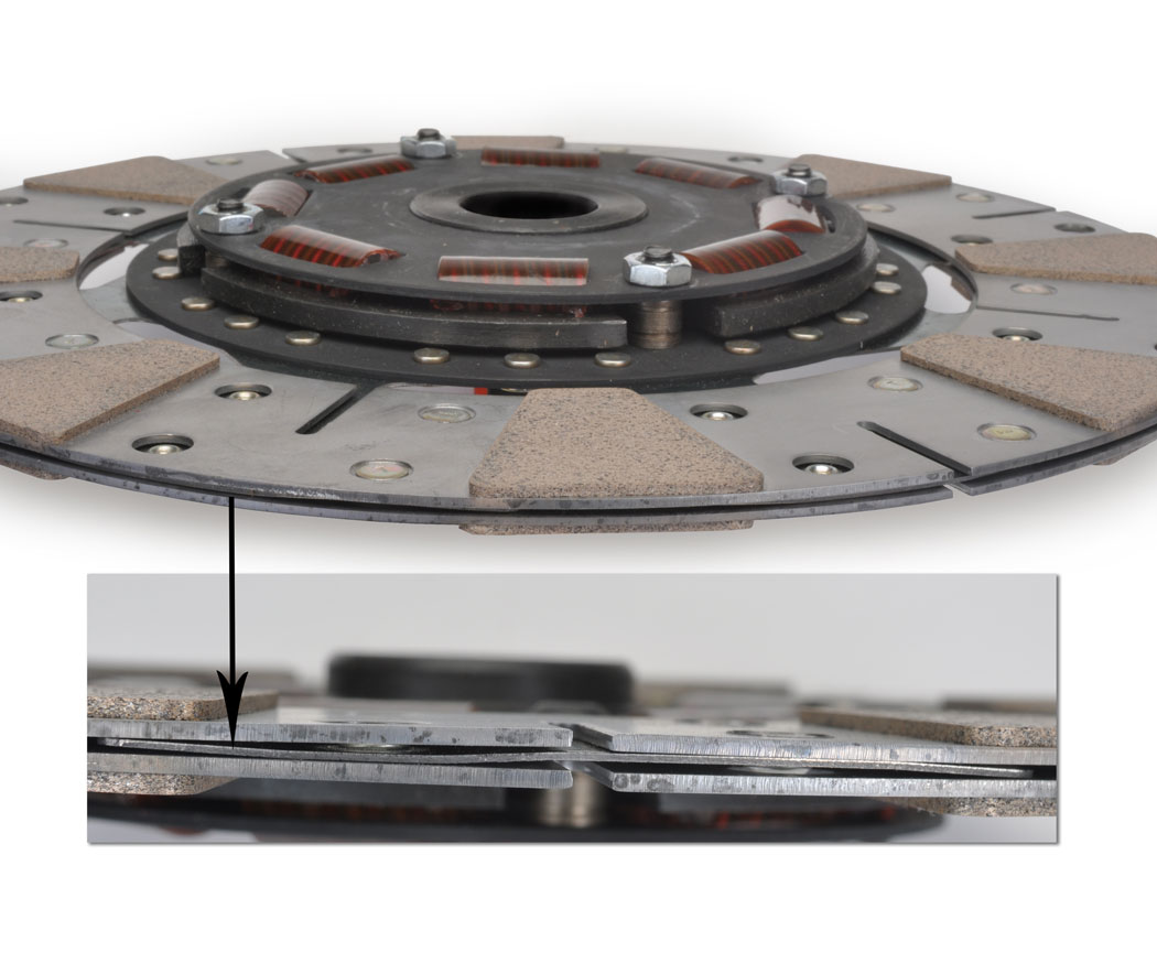

February 22, 201411 yr comment_442032 Otherwise, engagement point would be a function of the clutch disc diaphragm spring, I believe. It expands the two friction surfaces so that they make contact early, then full force is achieved when the spring is eventually fully compressed. Quoting myself. I dug around and found a good image of the center of the disc. Exedy calls it a "cushioning plate". Halfway down the page here - EXEDY - Clutch Info Link to comment https://www.classiczcars.com/forums/topic/48592-where-should-clutch-engage-on-1977-280z/#findComment-442032 Share on other sites More sharing options...
February 22, 201411 yr comment_442041 Thats a great link you posted Zed Head. Clearly shows all the inner workings of the clutch assembly.I didn't think the cushioning plate made that much difference to the "height of" engagement. It was more the duration of engagement and not just an on / off engagement like you get with performance clutches which don't have it at all.I beleive the centre point of the diaphragm spring has an effect. If you get the chance to compare the (240Z with the 280Z) model pressure plates, you will see the fulcrum point is a little further towards the outer section. I think Datsun did this in there general move to "refine" the car and slowly move away for that sports car feel the 240Z had. The 280Z pressure plates have the same clamping pressure, but then engage at a higher point and have a softer pedal.The disc in the early 240Z series 1 had little cushioning effect. Going back to the early 1980's. My best friend had one and the clutch engaged low. We had the clutch out several times and if I can remeber correctly, we were surprised at how little cushion effect it had compared to the monaro 350GTS I had, but we were told that was normal.I wonder if putting the 240Z pressure plate in the 280Z will give it that effect. They both have the same clamping pressure. Link to comment https://www.classiczcars.com/forums/topic/48592-where-should-clutch-engage-on-1977-280z/#findComment-442041 Share on other sites More sharing options...
February 22, 201411 yr comment_442060 I don't know how much effect the cushioning plate would have. You're right about the pressure plate. The disc and pressure plate are most likely designed as a set. I knew there was another name for the plate and found it, it's "marcel spring". Found another picture also. The picture is from this thread (Southbend...), which has a lot of griping and misinformed comments in it but also has some insight on the function of the marcel spring. Might be getting off-topic but you don't get many opportunities to talk about the odd little pieces. Post #21 might be the most informative but he doesn't give a reference. The Google could probably find it. (Found it - http://www.btc-bci.com/~billben/clutch.htm). Also found the original source of the picture - http://www.mooregoodink.com/news/rams-powergrip-clutch-greater-clamping-pressures-without-sacrificing-drivability/ Edited February 22, 201411 yr by Zed Head Link to comment https://www.classiczcars.com/forums/topic/48592-where-should-clutch-engage-on-1977-280z/#findComment-442060 Share on other sites More sharing options...
February 22, 201411 yr comment_442070 That is an interesting read, by that I mean post #21 in Southbend. The rest of the thread seems to be a rant over his clutch not performing to his expectations.I never knew it was called a marcel spring btw. Ive learnt something today:bulb: Datsun probably increased the size of the marcel spring in the S30 model over the years.I can't remember what the compressed distance was on the 240Z disc. We clamped the two in a bench vice to measure how far they compressed and measured them. The monaro clutch compresed a lot more.Chas Edited February 22, 201411 yr by EuroDat Link to comment https://www.classiczcars.com/forums/topic/48592-where-should-clutch-engage-on-1977-280z/#findComment-442070 Share on other sites More sharing options...
