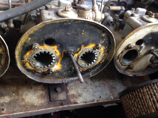

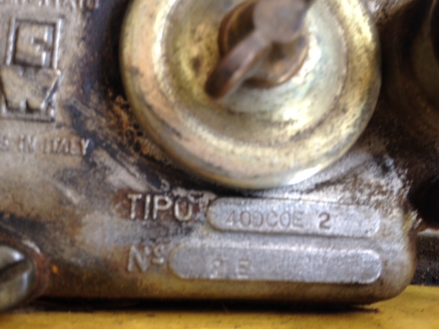

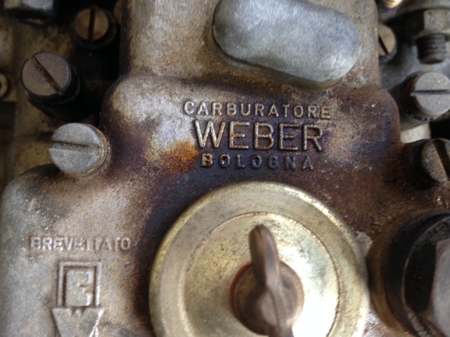

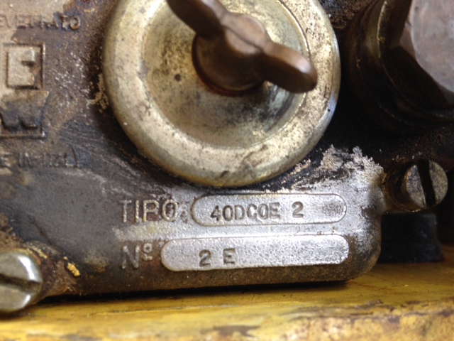

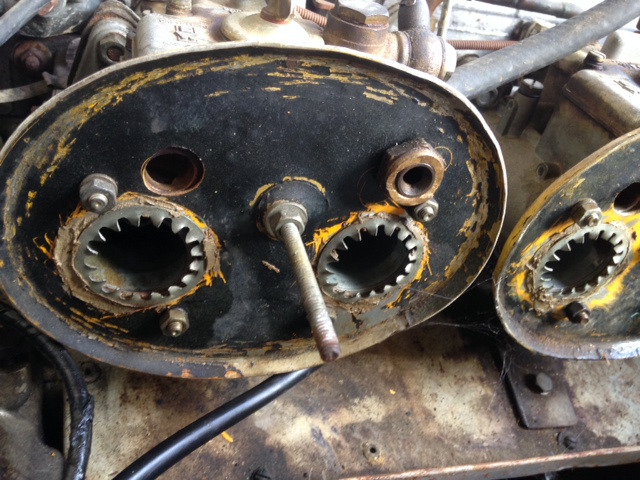

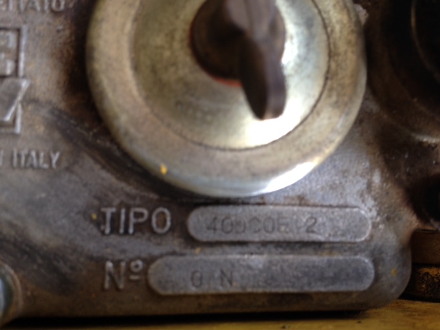

Need a little help. I'm rebuilding the carbs and replacing the filters. The carbs are Weber 40DCOE2, I'm having a
heck of a time finding the filters and the housing for them. I want to replace the yellow housing (mount and faceplate?) with either chrome or black or something else that is reasonable. Any suggestions??
