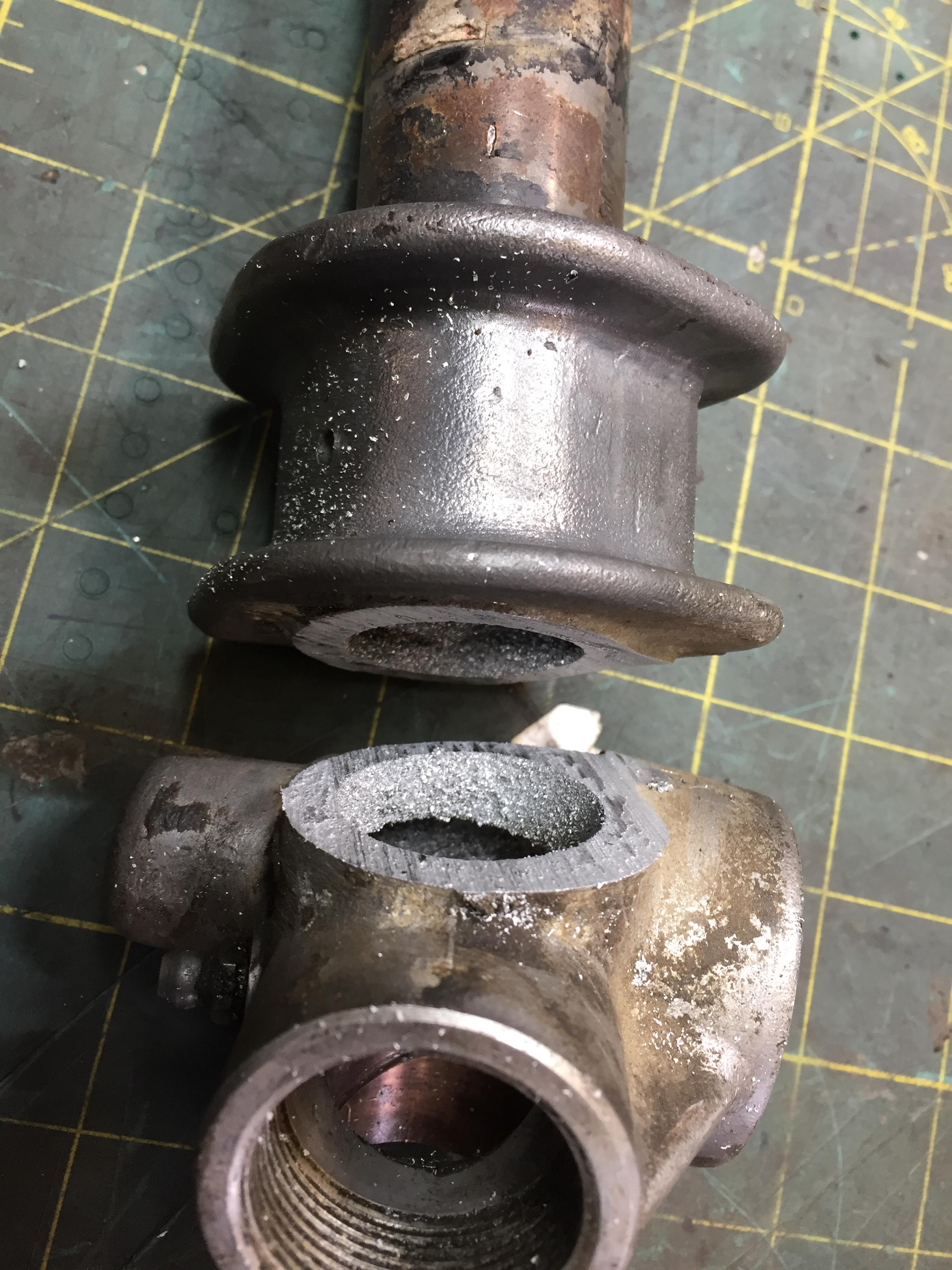

Ok, I hacked it off just between the flange and the pinion housing. This is past where the end of the steel inner tube seats in the aluminum.
Then I couldn't resist trying to separate the aluminum housing off of the steel tube. I drilled out the remaining metal in the two holes and heated the housing. Had the MAP torch out from doing the front cover repair. It came right off.
A point of note here, as I was heating the aluminum housing to expand it, molten plastic stuff began boiling out of the two  holes. Well after it came apart (easy, quite loose), it was apparent where that molten plastic came from.

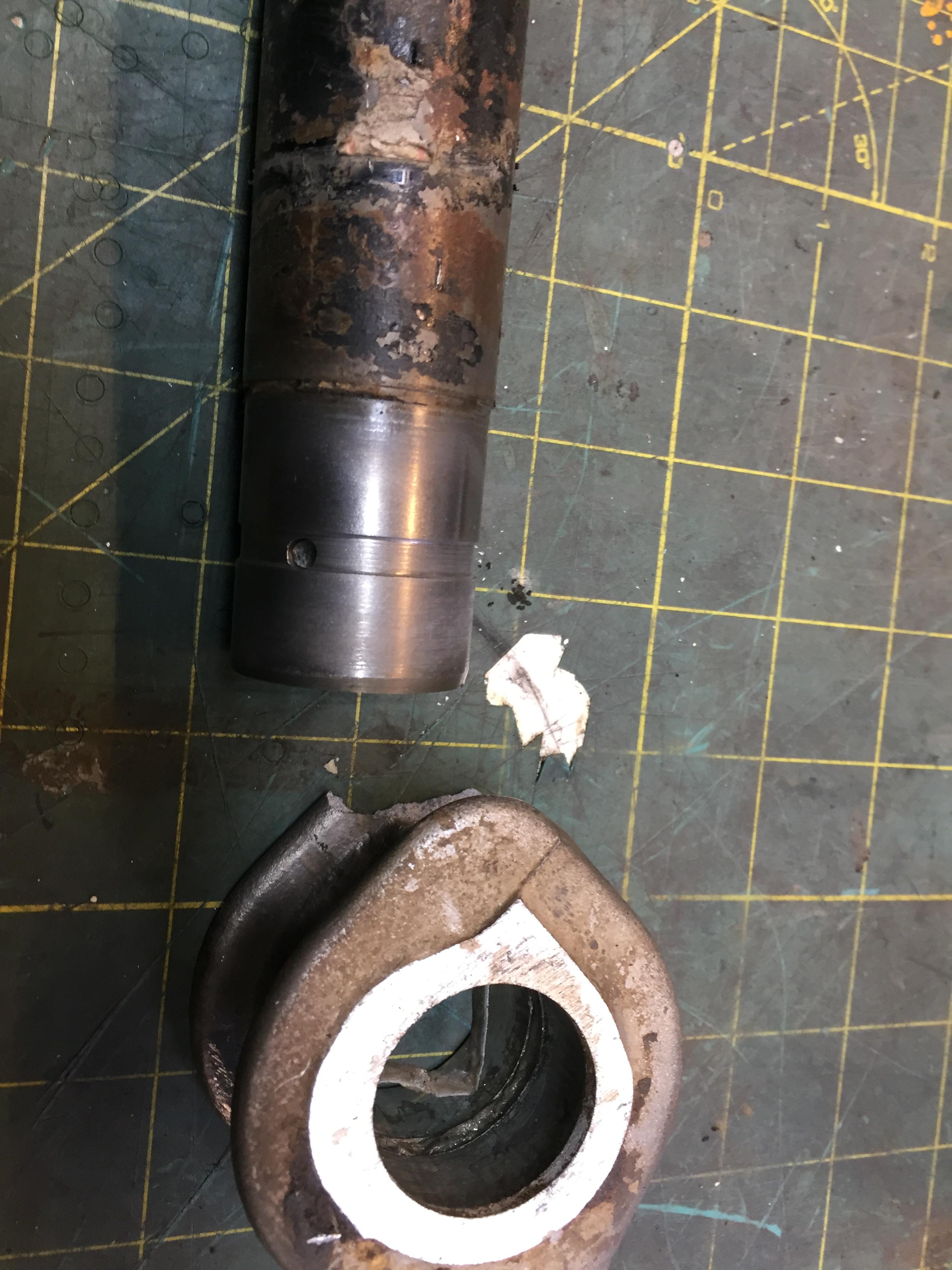

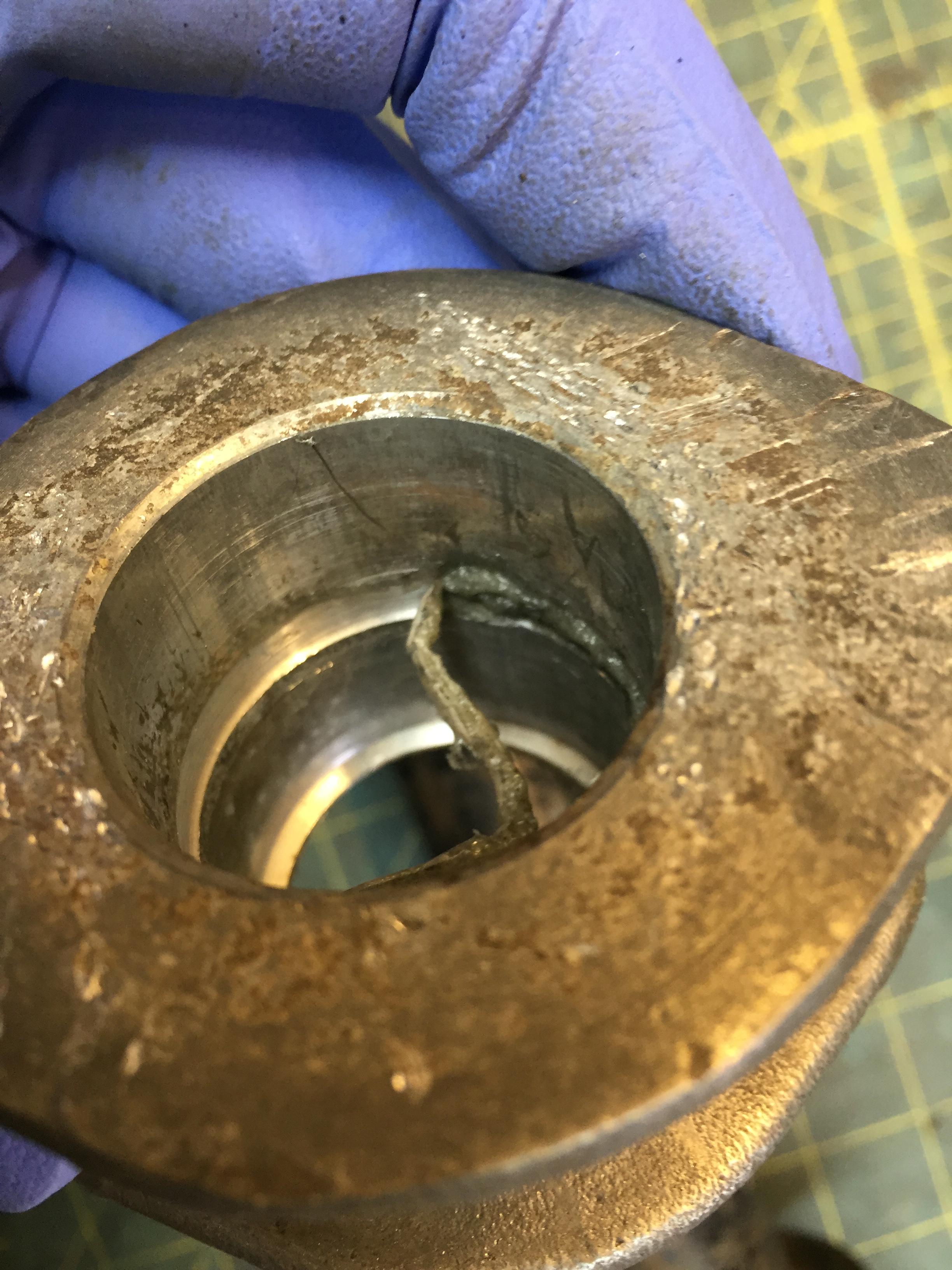

Both the steel tube and the inside of the housing have a groove, that was filled with that plastic stuff. Here is the picture with the remains of it in the groove after I picked at it.

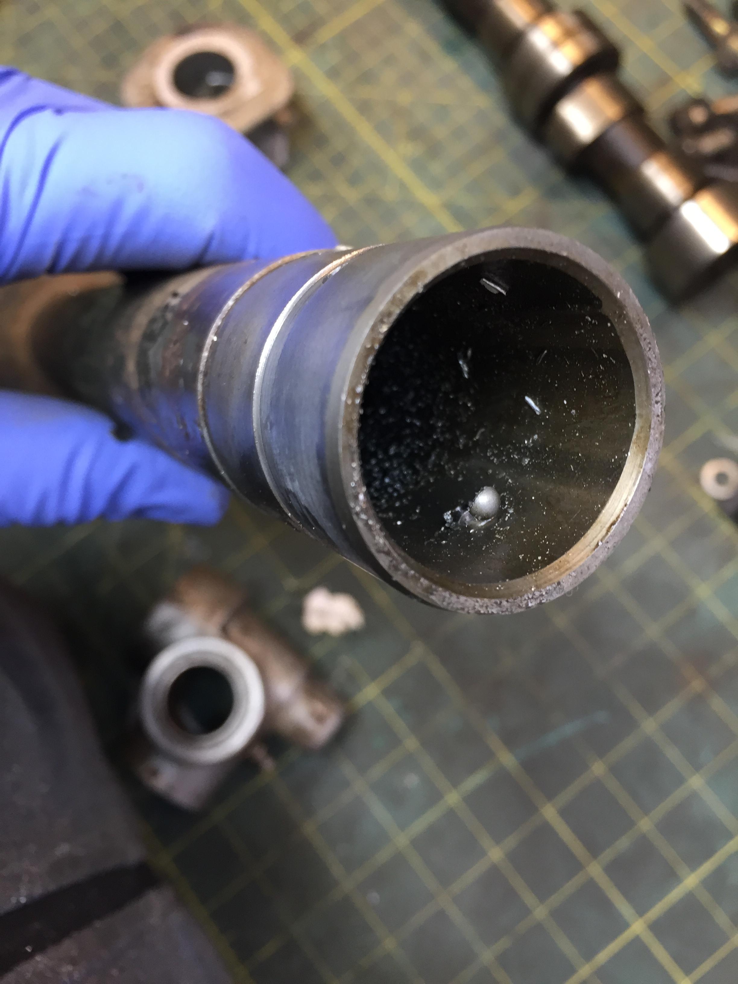

Here is the groove on the steel part.
This leaves me a bit perplexed. I drilled through metal for sure in both holes to get to the ID. But to fill that groove with plastic, you would have to have the outer hole open to the OD and groove of the steel tube to fill it. So maybe the groove space is injection filled, then some metal is pressed in to the holes lock the two metal together. I think the plastic is a moisture seal between the two. I would have just used a dang o-ring....
The aluminum housing was not a tight fit onto the steel tube. I can tap it back on now that it's off with just a little effort. It would definitely rely on the pin/metal in those holes to prevent rotation.
And here is the remains of the metal pin/plug after I drilled it out.
So I suppose for Mark's Powder coating melted plastic, there may be a moisture path in or grease path out if the plastic filled groove is not full anymore. Just a little silicon at the housing/tube junction might prevent anything from going either way.  No rotation prevention is likely comprimised though.

After seeing the grooves in the gearbox and the tube, and after hearing how loose the two pieces fit together now that they have been disassembled once... I stand by my original analysis!!
I think those two parts were aligned on a jig and then "glued" together with that plastic material to lock them in place. They were designed to be a little sloppy so the correct position could be achieved, and then locked into place with the plastic. I don't think there were any metal pins. I think it was all plastic injected under pressure into that groove until it came out the other side.

I agree.  It looks like the concentric grooves were filled to maintain alignment and to prevent the aluminum mounting flange from sliding up and down the tube (left/right relative to cars direction).... not to prevent rotating.

I didn't really grasp what the pictures showed.  Just to summarize, it sounds like we/us/the Z world is saying that the two metal parts are assembled, maybe fixtured, a pin is driven in to lock them together, then a molten plastic is injected in to the two grooves (which are apparently aligned).
I could see the plastic as a longitudinal lock, and the pin as a radial/rotational/locational lock.  Without the pin the tube can spin.  One probably came before the other.  A proper design might have the two functions combined.  "Dang it, this tube keeps spinning"...translated from Japanese.
