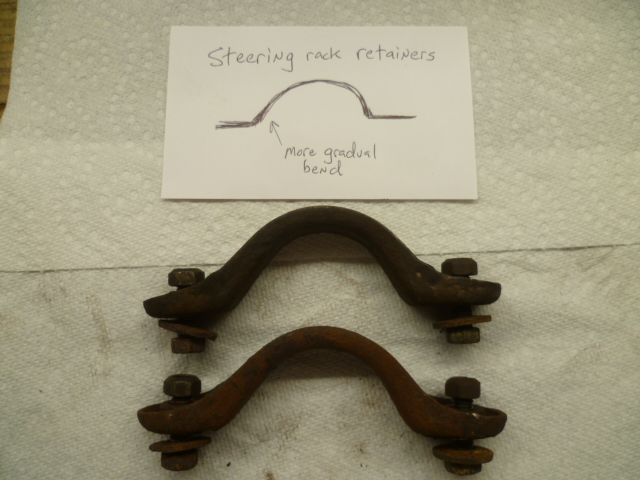

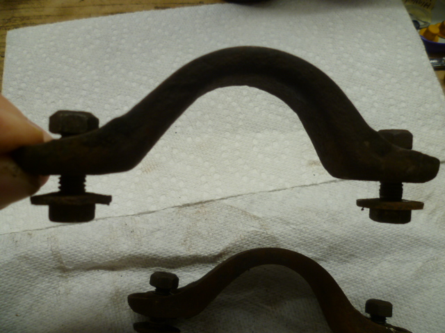

August 14, 20213 yr Author comment_626896 Since this topic is about steering racks... A little while ago I was messing with a donor steering rack and I noticed that the rack retaining straps appeared to be asymmetric. I've never ever seen any chatter about it, but it appears to me that these straps have a "front and a back"? The difference is subtle... I've included a sketch I whipped up to exaggerate and highlight the difference: The jury is still out on which way the straps should be installed, but here's what I found. I think the more gradual end goes towards the front of the car, but since I've never been in possession of a rack that hasn't been worked on in the past, I can't be sure: Thoughts from the collective? (This started on a different thread, but I thought it might be good to collect steering rack specific stuff here as well.) Link to comment https://www.classiczcars.com/forums/topic/48621-steering-rack-disassembly-and-refurb/?&page=15#findComment-626896 Share on other sites More sharing options...
August 14, 20213 yr comment_626897 I have several rack hold down straps. I’ll look carefully at all of them and report what shape variations i see. The bushings don’t have any unique front/back shape that I’ve noticed, or do they????? Edited August 14, 20213 yr by zKars Link to comment https://www.classiczcars.com/forums/topic/48621-steering-rack-disassembly-and-refurb/?&page=15#findComment-626897 Share on other sites More sharing options...
August 14, 20213 yr Author comment_626899 As far as I know, the bushings don't have a front or a back. Of course, the later years have a left and a right, but I've never seen any mention or heard any chatter about a front and a back. There's no mention in the FSM's that I could find. I was surprised to see what I (think I) saw. Makes me wonder if they really intended there to be an F/R and just didn't put that detail into the manuals. And it's not like I've ever heard anyone talk about problems there. "Yeah, I got some weird steering play that I can't figure out. I wonder if I got my retainer brackets on backwards." said nobody ever. Link to comment https://www.classiczcars.com/forums/topic/48621-steering-rack-disassembly-and-refurb/?&page=15#findComment-626899 Share on other sites More sharing options...
August 14, 20213 yr comment_626901 Quick look at the horde suggests if there are differences they are slight. I did find some that are bent from apparent over tightening, perhaps that accounts for the asymmetry you’re seeing? Link to comment https://www.classiczcars.com/forums/topic/48621-steering-rack-disassembly-and-refurb/?&page=15#findComment-626901 Share on other sites More sharing options...
August 14, 20213 yr Author comment_626903 Doubtful but possible? The gusseting on the curves should make that relatively difficult. I think you could bend an ear down, but I'm seeing differences further up the radius. Link to comment https://www.classiczcars.com/forums/topic/48621-steering-rack-disassembly-and-refurb/?&page=15#findComment-626903 Share on other sites More sharing options...

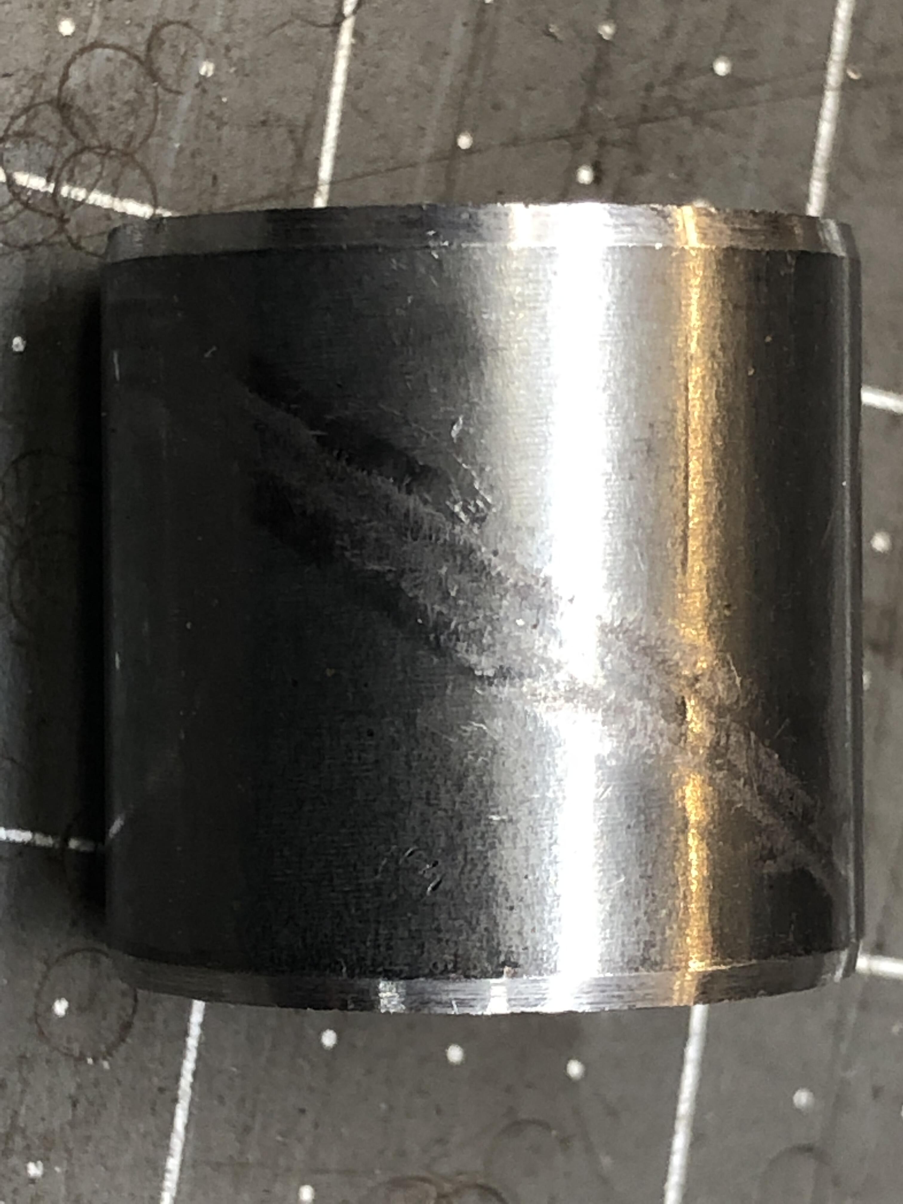

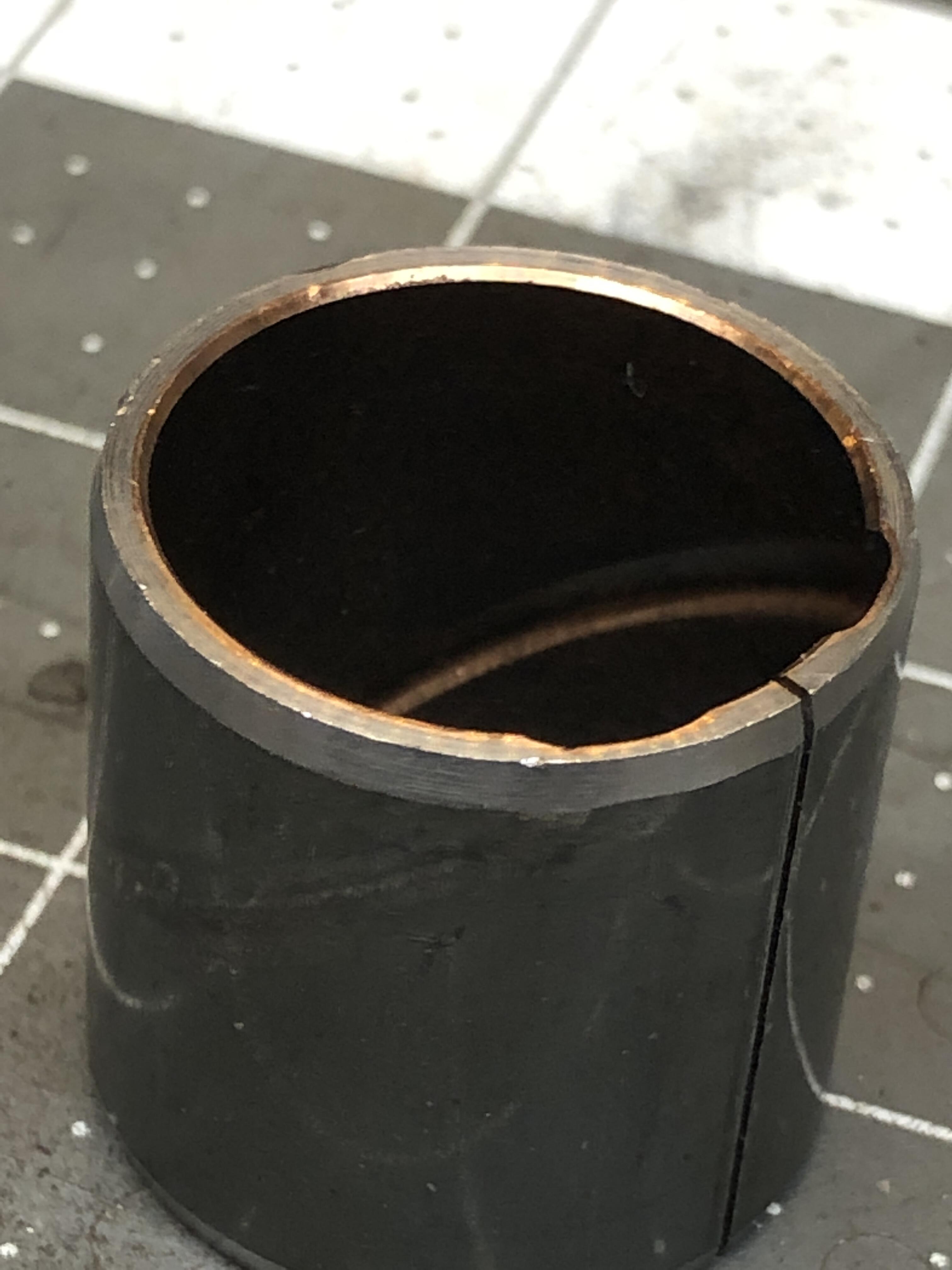

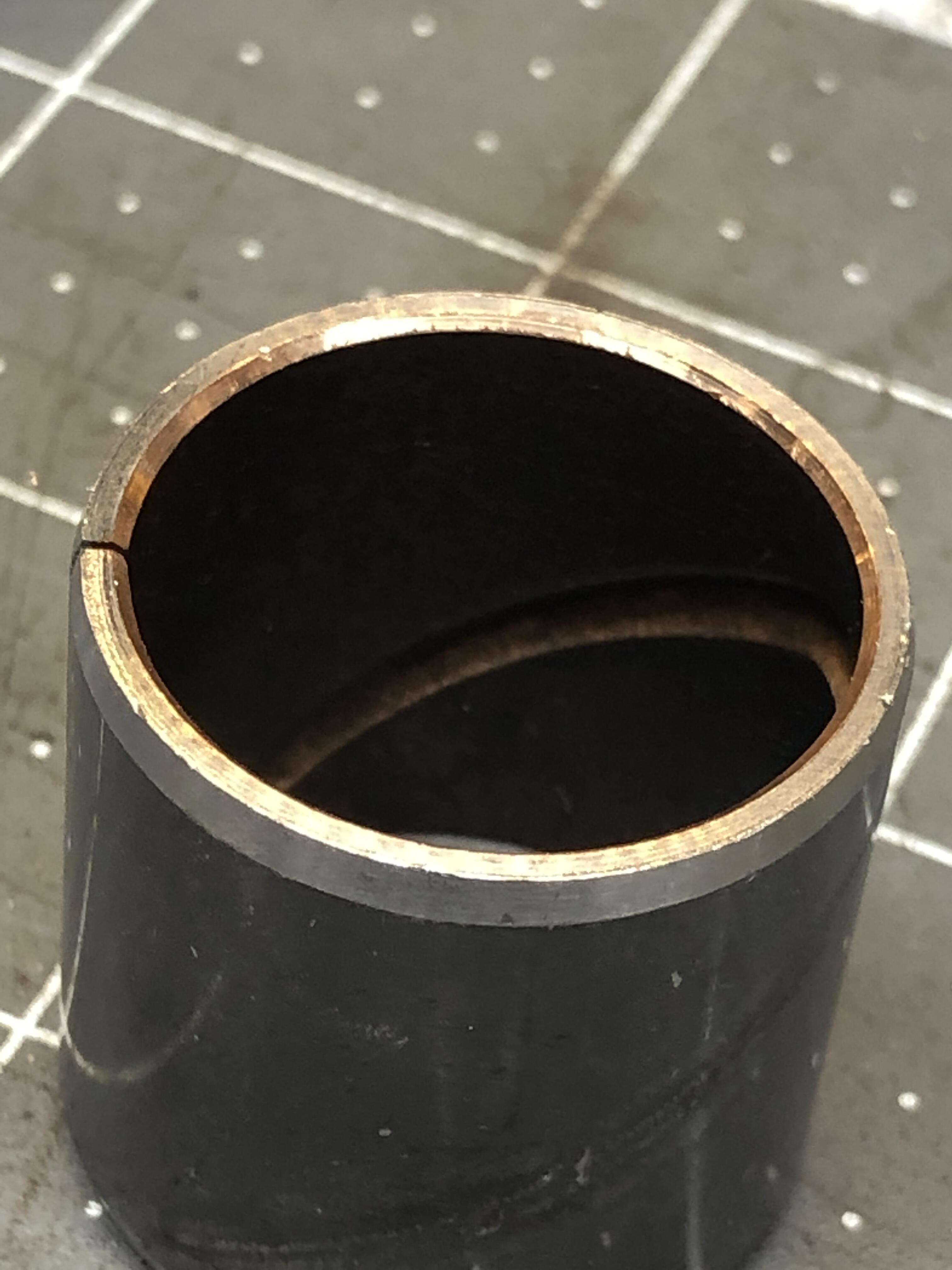

August 14, 20213 yr comment_626921 Took a couple more close up pics of the new bushing. Link to comment https://www.classiczcars.com/forums/topic/48621-steering-rack-disassembly-and-refurb/?&page=15#findComment-626921 Share on other sites More sharing options...
August 14, 20213 yr comment_626931 Was the OE bush split? Link to comment https://www.classiczcars.com/forums/topic/48621-steering-rack-disassembly-and-refurb/?&page=15#findComment-626931 Share on other sites More sharing options...
August 31, 20213 yr comment_627838 On 8/14/2021 at 5:59 PM, Namerow said: Was the OE bush split? Have to take another apart to look. BTW, no problem getting more of the longer bushings. Haven’t tried to do anything about actually put it in or any other other than restoration re-assembly, but someday I’ll have a few racks with new bushing available. Link to comment https://www.classiczcars.com/forums/topic/48621-steering-rack-disassembly-and-refurb/?&page=15#findComment-627838 Share on other sites More sharing options...

October 12, 20213 yr comment_629898 On 10/11/2021 at 3:45 AM, Salonmi said: Hi zKars! I need two of those bushings 🤔 Where can I get them please 🙏 I can send you two of the ones I got, or you can order your own from : megazip.net 48128-78500 is the part number. Took less than two weeks to get to me. $30 USD to get them via EMS shipping. Remember they are the long right side ones, so the left side will need to cut flush once its pressed into the housing. Haven't done any yet, so help tips about how to do it, but I would heat the housing to 300-400 F in the over to expand it and freeze the bushing to make insertion easy(er). They are bronze or similar, so not very hard.... Jim Link to comment https://www.classiczcars.com/forums/topic/48621-steering-rack-disassembly-and-refurb/?&page=15#findComment-629898 Share on other sites More sharing options...
