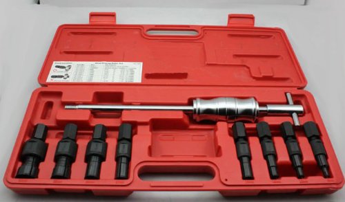

how did you manage to get the lower pinion bearing out?
I used a device called a "blind bearing puller" which is an expanding mandrel on the end of a slide hammer.
You put the mandrel though the inner race of the bearing while it's down in the housing, expand it until it's tight, and then use the slide hammer to "knock" it up and out of the housing.
Prices for such a tool are all over the map depending on quality. Here's a pic of one such device. This one is a little over $50 on Amazon:
