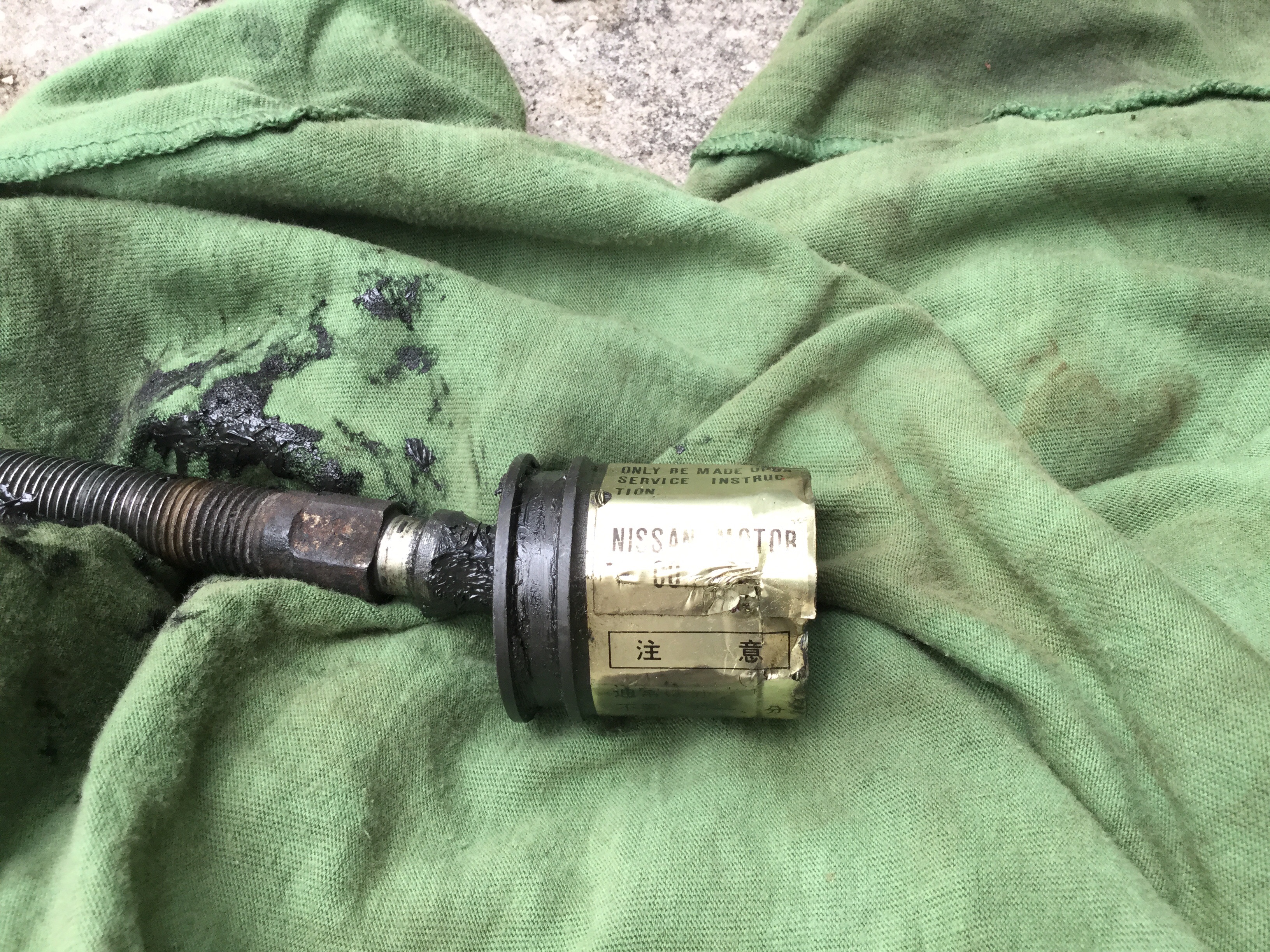

Yes, that is a lock nut. You thread the tie rod end onto the end of the rack and then tighten the locknut against it to lock the end in place. In that pic, the locknut had been backed off the tie rod end a turn or two. That's why there is a small gap between the tie rod end and the locknut.
I think my style of tie rod end (round with the weld spots on it) is the original factory design. If yours had multiple flats on the sides and wasn't welded together, I think it was replaced at some point.
No MINE is original OEM. Haha!!
Interesting. Maybe Nissan made some other design as well?  Mine came apart too. I was just shocked to see the original sticker still on mine.

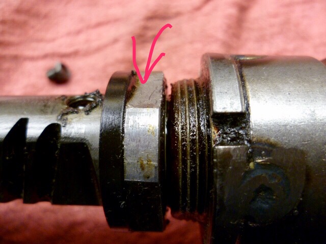

On 10/8/2017 at 9:26 AM, Captain Obvious said:
Here's a shot of the shot in the rack. Note the smooth rounded fillets in the corners:
One more.... what is the purpose of the small plastic plug under the driver side bushing? White in your picture here.
My concern is, I plan to powder coat this part...
I actually don't know the purpose of the plug that you point out on the rack although I had the same on the racks that I have rebuilt.  I guess that it may have been something used in manufacturing for perhaps the initial greasing of the assembly but needed to be plugged for actual use.
Having said that I have powder coated multiple racks like this without any issue. I just left the plug in tact during the powder coat process.
