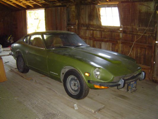

Love those old LA photos. Looking at the smoggy grey skies brings back memories. At first glance I thought it was another california barn find car that had surfaced a few years back.
Plates and color are different though.
