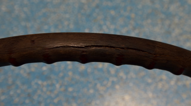

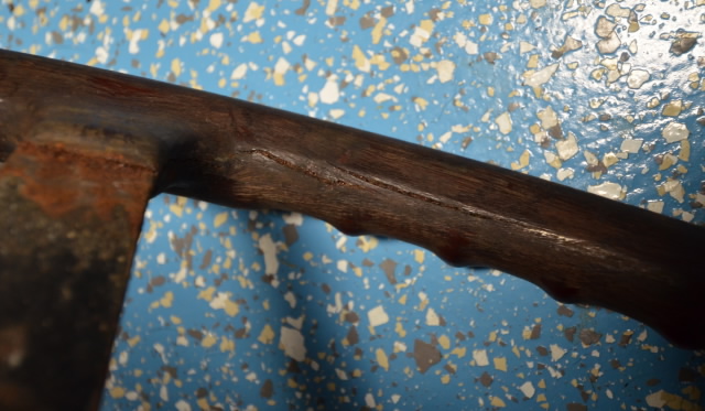

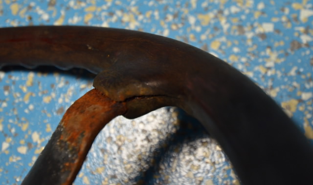

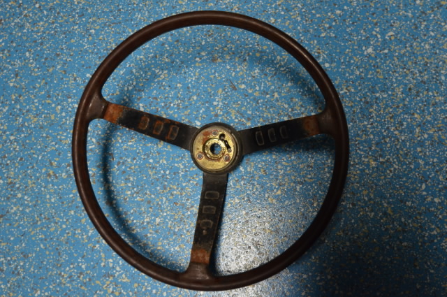

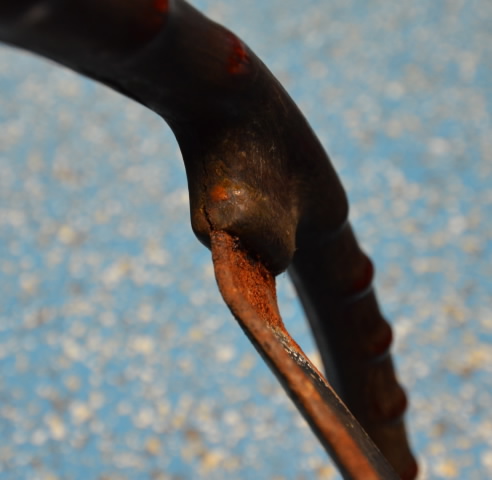

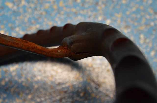

Posted March 4, 201411 yr comment_442664 I did a bunch of searches using different text and could not find any threads regarding repairing cracked "wood" on the steering wheel. I have a series 1 wheel and when I removed the cheesy wheel cover I found these cracks. My thought was to fill them with some stained epoxy. I am just not sure how that would work out especially the the spoke meets the "wood". It looks like the rust goes under the "wood" and I expect would keep rusting and splitting the connection. I saw a lot of posts for cleaning the "wood" and repainting the spokes. Just no repairs for this. Any input would be great. Thanks Link to comment https://www.classiczcars.com/forums/topic/48676-steering-wheel-repairs-for-cracks/ Share on other sites More sharing options...
March 4, 201411 yr comment_442665 Wow, that might be the worst wheel damage I've ever seen. I'de suggest a thorough sand blasting, excluding the wood, with something relatively gentle, then fill the cracks with a filler that will take stain. Given the extensive nature of the cracking, you'll end up with some pretty obvious stain differences unless you take to someone who can recreate the grain appearance ontop of a solid paint job that will hide all the repairs. This = big $$.You could always get a better condition Series 1 wheel unless you're super attached to that one. Let me know, I can set you up with on at a reasonable cost. Link to comment https://www.classiczcars.com/forums/topic/48676-steering-wheel-repairs-for-cracks/#findComment-442665 Share on other sites More sharing options...

March 4, 201411 yr Author comment_442668 Thanks for the offers Jim and Jim. I have a 72 wheel that is an easier clean up. I was just trying to find out if this S1 was even fixable to the point where it look proper, not necessarily a show piece. I just hadn't seen any posts about fixing any crack in the "wood" part. Seems to me like zKars Jim said big $ and a lot of work to make it look right. Fortunately, I am not in it much so it might just end up on Ebay and the the bidders decide what it is worth.Seriously though, has anyone attempted a repair like this, even just a small outer rim crack? Just curious now. Link to comment https://www.classiczcars.com/forums/topic/48676-steering-wheel-repairs-for-cracks/#findComment-442668 Share on other sites More sharing options...

March 7, 201411 yr comment_442918 Was that wheel from a wreck? It sure looks bad. It appears the outer part of the wheel has been pushed towards the front of the car. You may have to straighten that if it is.The rust down in the joints is a problem. It looks like it is holding the wood out away form the steel. There are ways to remove the rust by electrolysis that may not cause further damage to the wood. After cleaning the rust form the wheel I would use the epoxy and saw dust filler. Use a wood that is close to the color you want the wheel finished color to be. Paduak or Bloodwood are redish colored woods that may work. Link to comment https://www.classiczcars.com/forums/topic/48676-steering-wheel-repairs-for-cracks/#findComment-442918 Share on other sites More sharing options...
