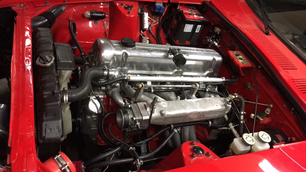

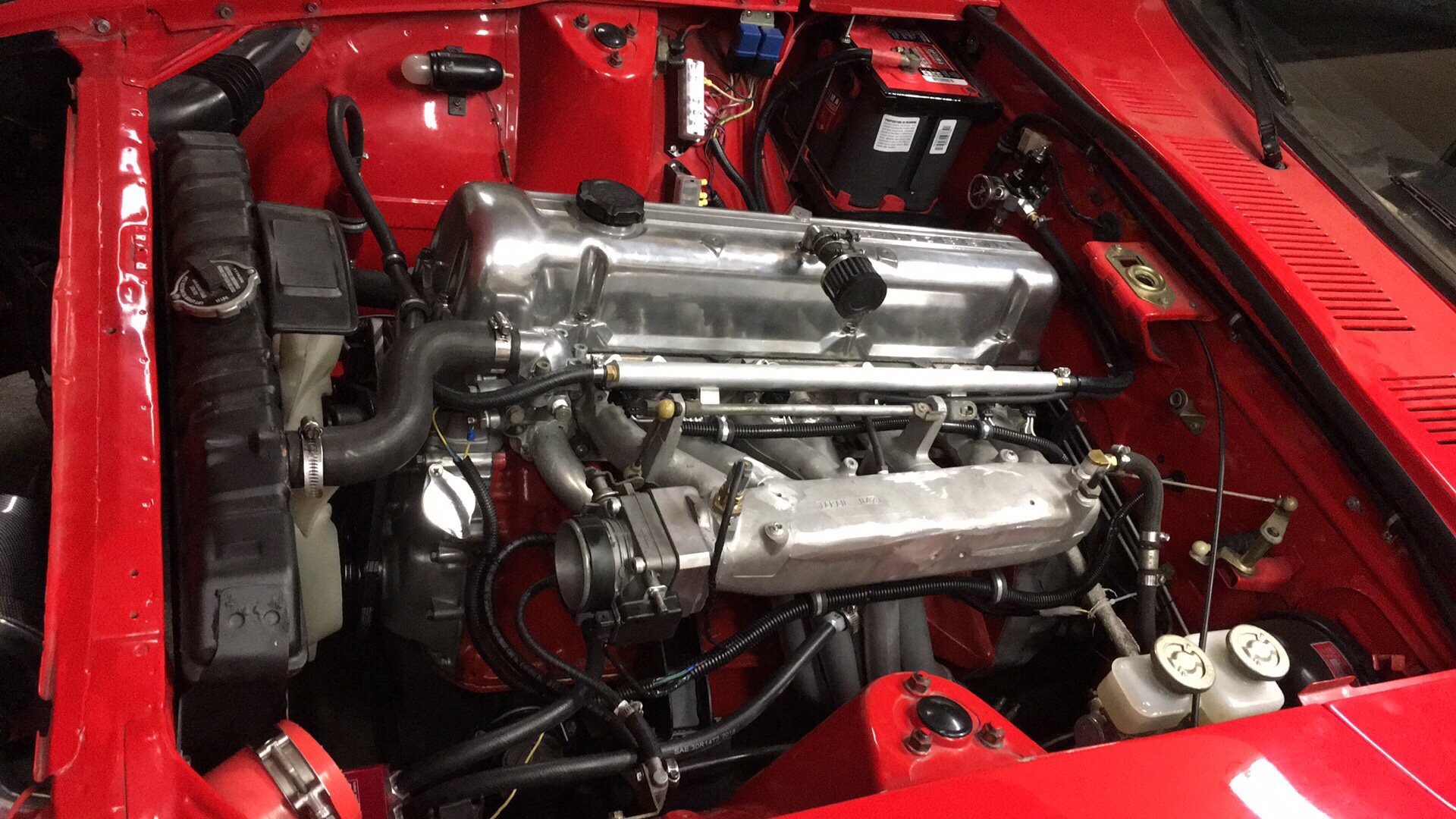

So as you might have figured out I am kind of STOKED about this. This happened pretty smoothly all things considered. I committed myself after selling the Mikunis, which forced me to make this happen or not be able to drive my car this season. I also had major home improvement projects going on , including building a Z shop behind my house.
The ignition side of this install I have been using for a year or so and it's been very stable and tunable. This fuel part included a lot more changes because of fuel pressure requirements needed converting from my carbed car. So far no leaks and very quiet fuel pump has worked great. The beauty of this is the options for tuning you can never achieve with carbs. I drive my car everyday and every chance I get - so being able to get in and turn the key to a well running sports car to run to the store or a cruise is awesome. I have lost nothing in regards to the driving experience compared to when it was carbed with the Mikunis.  I never had the induction noise experience since I ran a CAI, not sure if I would have heard it with my exhaust anyway, so nothing lost there. Admittling the view under the hood is not as classic or pretty as the triples, but OER makes FI triples!!! I do miss the punch of the accel pumps of the triples, but I'll get this dialed the same eventually.
When I get to the point where I'm feeling confident on tuning I will take her to the dyno. Since I bumped CR, I hope to see a little gain . Right now with very little tuning and conservative timing it already feels as strong as before .
I want to thank Richard- chicken man- for helping me out getting a baseline tune going on this. As usual , the Datsunguys are a class act . These big projects can get discouraging and frustrating , but hearing it light off for the first time after all the work makes it worth while. Richard got on line with me and I was tuning at 11pm that night in the garage. I was in the dog house after that with the Mrs. since I stunk up the house with exhaust fumes , but I cooked dinner the next night and all was good.
The next morning  after Richard put a tune on my car I drove it on its maiden voyage to C&C . It drove pretty damn well too!
No looking back to carbs again- for my car anyway
