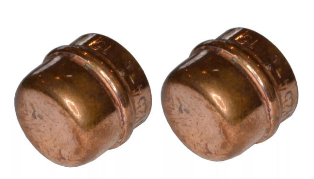

I’ve used copper end caps with a piece of copper pipe soldered in and a jubilee clip to great effect. The PO had used the bolt method which had corroded a lot reacting with the coolant.
The copper method works a treat and totally heat proof!
