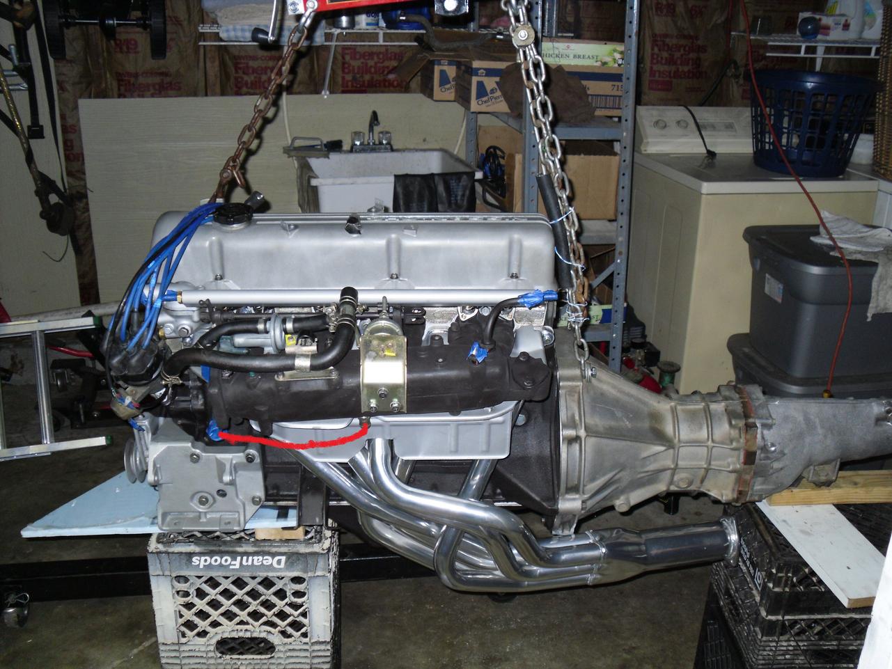

I just replaced the head gasket on my FI 1976 and now I'm putting things back together. I'm wondering, if I go with the MSA ceramic headers, which supposedly decreases radiant heat by 40%, do I still need to put that ugly heat shield back under the intake manifold? To me, part of the attraction of headers besides flowing better and being lighter than the cast iron manifold, is they look nice, but with the stock heat shields, you can't see much of them.

After reading about excessive heat I decided to clean mine and paint them with high heat aluminum rattle can. VHT Flameproof for headers. Some serious heat comes off my header runners but above the shield it's not hot at all, my fuel rail is even cool to the touch, all your wiring and injectors will last longer if you use them I would think. At least use the horizontal one, IMO. You can put it on afterwards if you decide not to use them now, I took mine back off to paint it satin black. And I had to trim the vertical one for mine.

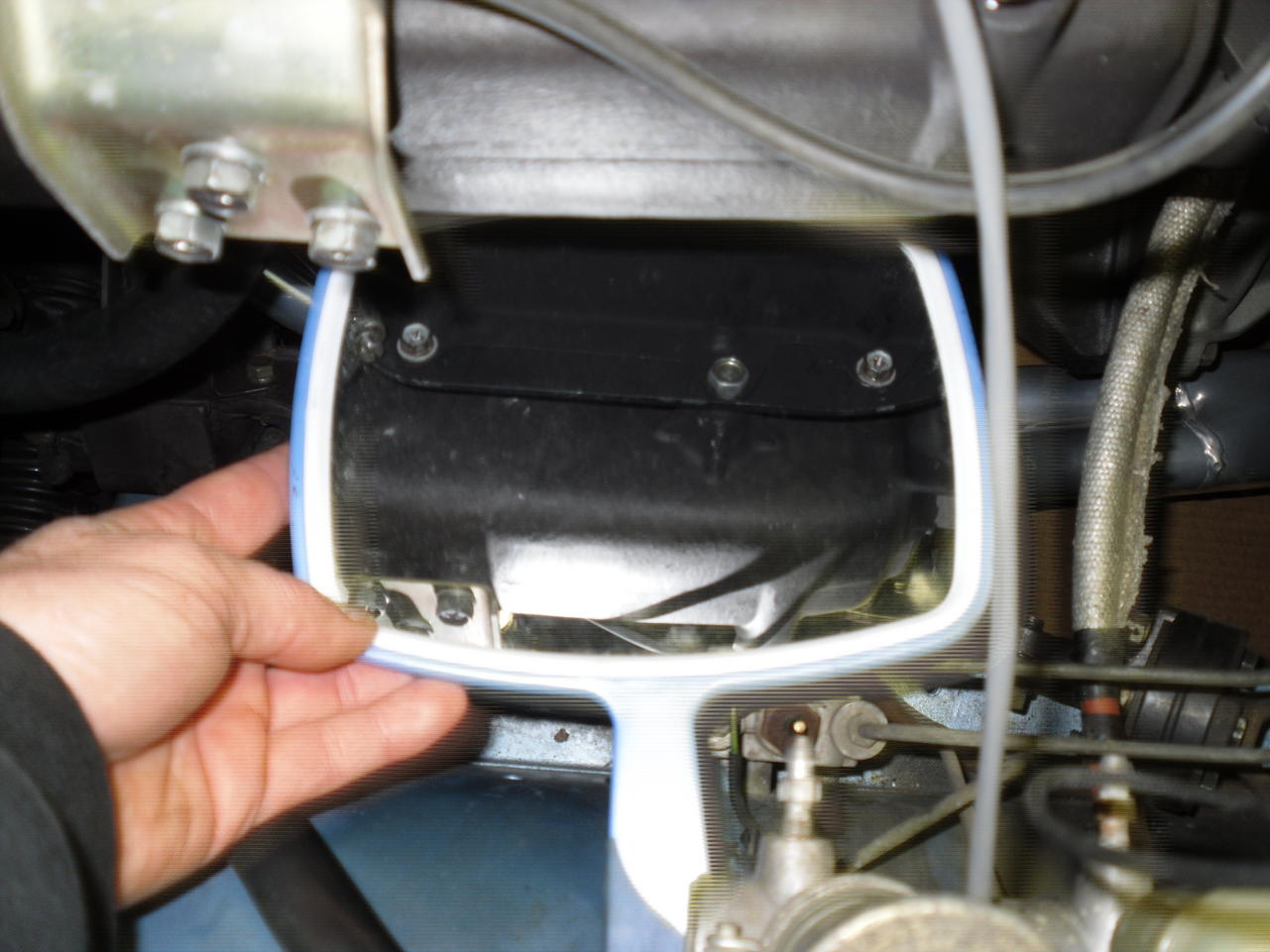

SU is showing another possibility, which would actually be generally useful. A reflective surface somewhere on the fenderwell. I use a mirror quite often to look around under the manifold and various other places. It would be nice to have something permanently in place. You could even go further and point some LEDs up under there. Call it a maintenance inspection tool.
