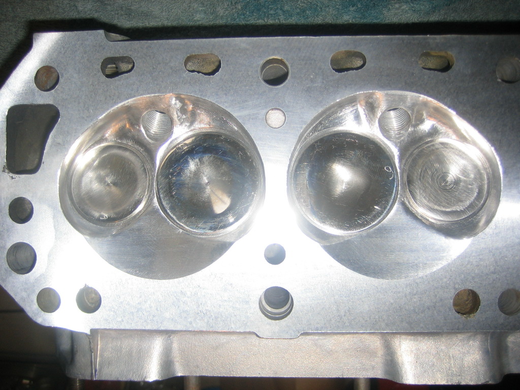

March 17, 201411 yr comment_443557 Early e-88 like this? How common are those heads in Oz? Link to comment https://www.classiczcars.com/forums/topic/48751-e88-head-on-an-n42-block/?&page=3#findComment-443557 Share on other sites More sharing options...
March 17, 201411 yr Author comment_443558 Yep, we got those early heads too, just like the one you posted. I will tell you, at TDC when I was putting on the head, the chamber on cylinder 3 (IIRC) was so laid back around the spark plug area, you could see all the way into the chamber and see the head gasket and the hone marks on the top part of the bore....EASILY!! And the valve was not at full lift either. Your E88 head has the wrong part of the chamber laid back, the side on the short side radius of the port. When you think about that for a moment, it makes perfect sense to lay back the area around the SPARK PLUG the most for ease of entry into the cylinder through the port. No, not very common anymore, they've been snapped up because they're good to use for NA L28's. You want one? Edited March 17, 201411 yr by ozconnection Link to comment https://www.classiczcars.com/forums/topic/48751-e88-head-on-an-n42-block/?&page=3#findComment-443558 Share on other sites More sharing options...
March 17, 201411 yr comment_443577 YES! Too bad you are half a world away.They are probably as hard to find as the MN-47 over here.Like to see a direct comparison between the P-90 and that head. Edited March 17, 201411 yr by madkaw Link to comment https://www.classiczcars.com/forums/topic/48751-e88-head-on-an-n42-block/?&page=3#findComment-443577 Share on other sites More sharing options...
