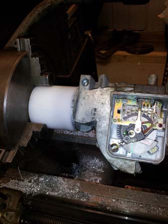

March 16, 201411 yr comment_443530 Unfair, on the Mustang. It's the same way here, you work on everyone else's first then yours....at midnight...with the windows blacked out so they don't know you're in there. YES on the stock NA ECU, stock NA injectors, & stock NA AFM. If all three of those match & nothing else is wrong of course, it should run your L28 engine. Zed, I had forgot that the turbo AFM might be a bigger bore. (I don't know what they are, but the NA AFM bore where it connects to the throttle body boot is definitely 2.75" - I just turned an adapter on the lathe yesterday). I understand why people try to swap them around, but I'm not a believer of needing a bigger TB or AFM unless you have done some serious head work on our Z's. The main limitation is the head, not the intake system.... I think. This was the adapter I was making yesterday to mount this AFM on a flowbench to pull some numbers. BTW, I am going tomorrow or Tuesday to work a deal on maybe 12-15 AFMs. Hopefully some will be turbo. If they are, I can do a good apples to oranges comparison for us. Len Edited March 16, 201411 yr by superlen Link to comment https://www.classiczcars.com/forums/topic/48762-ecm-questions-240z-to-280zzx-swap/?&page=3#findComment-443530 Share on other sites More sharing options...
