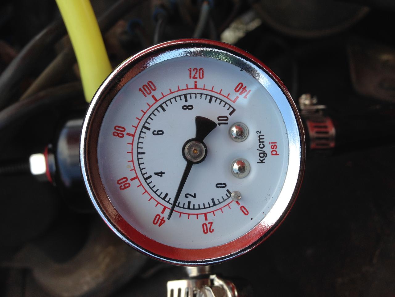

Alright so I put a fuel pressure gauge in and heres what I got what the fuel pump kicks on before the car start:

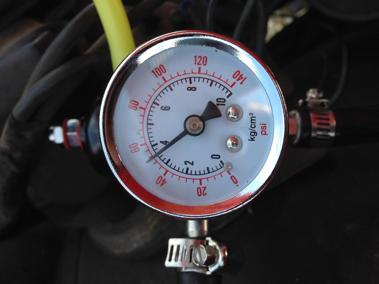

And this is while its running at idle:
And it would increase with the R's up to like 45 psi. It'll still rev like i said but under torque it wont go above 2500rpm. and It starts to get worse the longer the car runs.
I really really wish I had a l24 and carbs... :disappoin
The numbers are high by about 9 psi. It's odd because your pictures show what appears to a be a stock fuel pressure regulator (FPR) with the vacuum hose attached. There's an old trick people do where they dent the top of the regulator to put preload on the internal spring to raise fuel pressure. I wonder if the PO did something like that.
This wouldn't really explain the lack of power. You would have a gassy exhaust smell and might foul plugs but it would probably still rev higher with reasonable power.
Overall, just another wrongness. I still wonder about the AFM/ECU match as a cause. These engines will actually run without an AFM, on idle fuel enrichment, indicated to the ECU by the TPS idle position. With high fuel pressure you might have just enough fuel to match the air to get you to 2500 RPM. You might not be getting any AFM enrichment fuel at all. Try disconnecting the AFM plug and see if anything is different. That would tell you something.
Looks like the FPR is building up to much pressure. Seems to be about 15psi to high, although that might be to your advantage with the NA injectors on a turbo setup. The higher pressure wil compensate for the lower cc value of the na injectors.
If I recall correctly, don't have my notes handy atm. I was getting 48psi when I clamped the return line shut, when the vacuum line is disconnected it went to 35psi and at idle with vacuum line connected it sat around 26psi.
