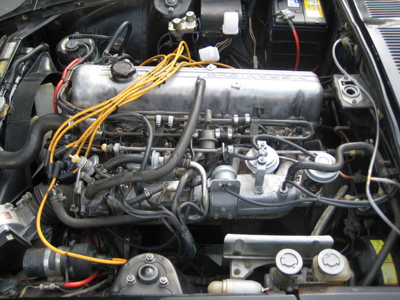

Got the pics of the engine bay too, anything stand out?
Looks untouched, which is good and bad. Good that it's original but bad because you've got a lot of work to do. You're going to need to pull the valve cover off to oil the valve train before cranking it so there's your chance to clean that. You're going to need to clean the electrical connections, http://atlanticz.ca/zclub/techtips/electricalconnections/index.html. After draining the tank put a cheap clear fuel filter between the tank and the fuel pump, Z Car Tech Tips Fram G3 Filter Installation. Open the air box behind the front bumper and clean all the acorns out then get a new filter, they're cheap. Get a new metal fuel filter, passenger's side of the engine bay up front. Once you have new filters in you could straight wire the fuel pump to build up the pressure, which is about 30 something PSI so be careful, and look for fuel leaks around the clamps and maybe a rotted hose or 2. Change the oil and filter with cheap stuff from Walmart for the 1st time. Drain the radiator and flush it out, pull the old thermostat out and loosen the bottom radiator hose to flush out the engine coolant passages too. That's the first few hours. Oh yeah, I wouldn't spray the engine off with a hose pipe. I know it's tempting but a good Scotch Brite pad and some Simple Green with lots of rags works fine and keeps moisture out of the electronics. You've read all this before but I'm drinking coffee and it's raining! Again, a GREAT looking car.
