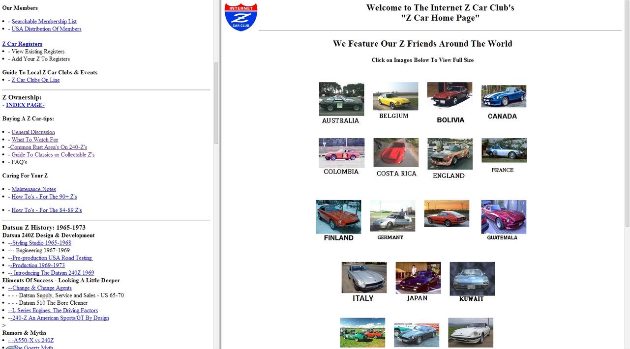

You said you read the link I posted. It has much if not all of the information you requested. Please note the topics on the left side of the screen.

The website Steve linked is a great source for information
