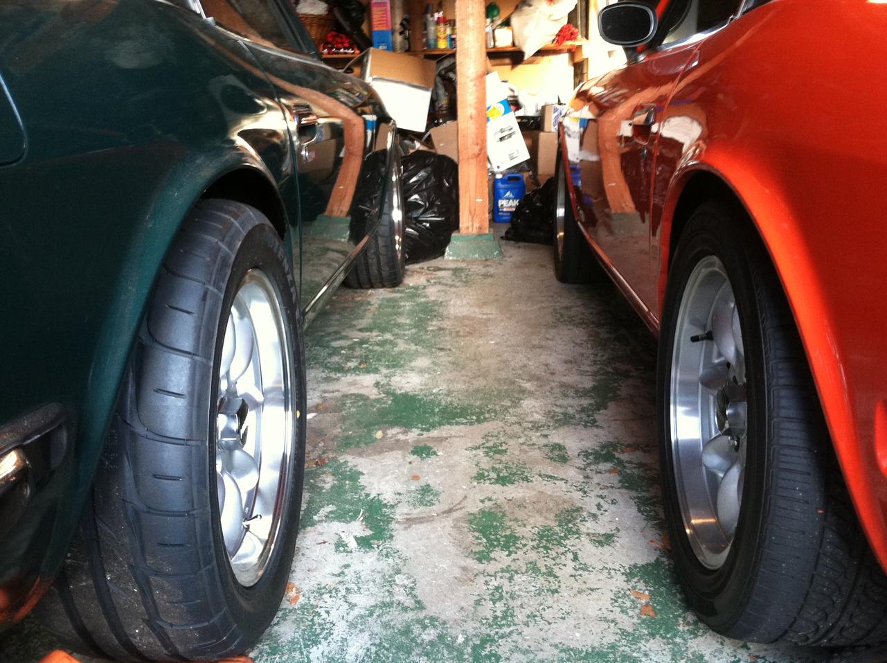

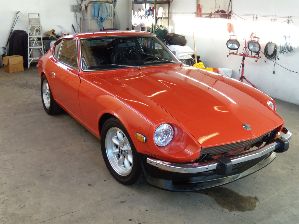

March 20, 201410 yr comment_443791 I have a set of 225/50R16 tires on 16X7 Panasports on both of my Zs. I think one set is +6 offset and one is 0 offset, but I got both sets secondhand. After mocking up both sets on one car, I think the tires make a bigger difference than the slight offset (although that helps). The RE-11As on the green car are quite a bit "bulgier" than the Turanzas on the orange car. The facts... - Orange car is on +6 offset with very old 225/50R16 Bridgestone Turanza rubber. - Green car is on +0 offset with 225/50R16 Bridgestone RE-11A rubber. - Green car has +0 deg of rear camber, orange car has -1.5 deg. - Green car has trimmed rear arch lips and front valence - Orange car has aftermarket air dam - Zero rubbing on either setup - Switch sets between the two and fatter rears will rub on orange car Edited March 20, 201410 yr by LeonV Link to comment https://www.classiczcars.com/forums/topic/48796-wheel-size-2255016-6-off-set-will-work/#findComment-443791 Share on other sites More sharing options...
