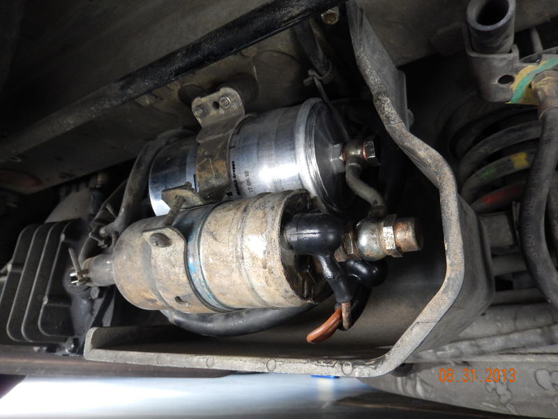

It appears the optimal location for the accumulator is right next to the fuel pump.
this is a mercedes setup.

The only affect the accumulator has on fuel pressure while the pump is running, is that
it keeps the pressure more steady because of the reservoir of fuel it has. The magic happens
when the car is shut off and the spring and diaphram take over and supply residual fuel pressure.
