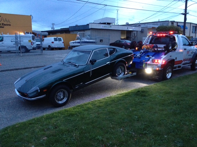

April 16, 201410 yr comment_445880 i believe my problem is an EFI electrical issue which has somehow been exacerbated by or is simply coincidental to hot-start conditions, so i'm going to start a new thread to try and keep this thread on-topic. let's just say today wasn't a banner day for the z... Edited April 16, 201410 yr by rossiz Link to comment https://www.classiczcars.com/forums/topic/48810-hot-start-issue-with-efi-who-has-it-who-doesnt/?&page=6#findComment-445880 Share on other sites More sharing options...
