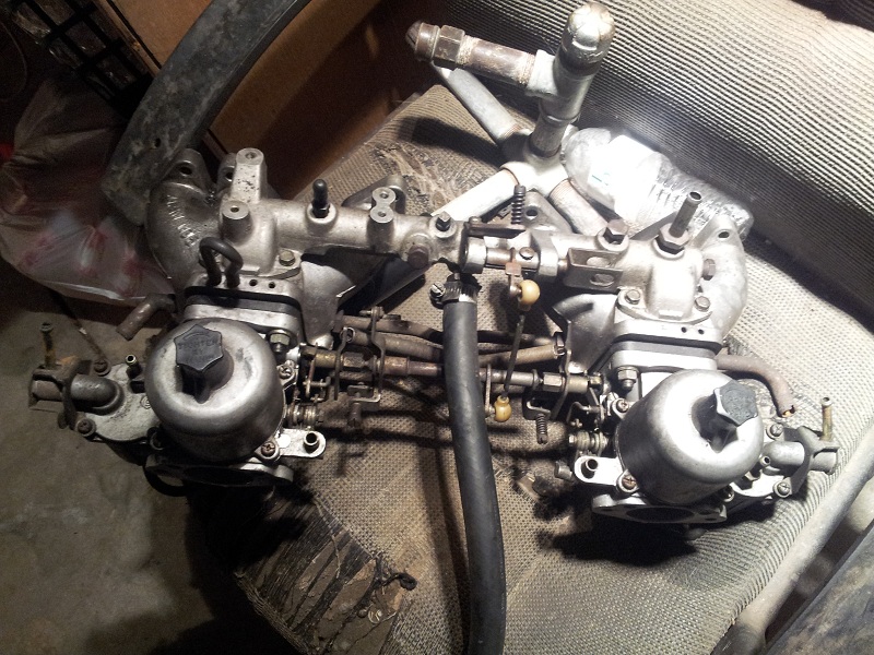

Posted March 28, 201411 yr comment_444383 I'm putting together my conversion to SU's from the weber DVG's. I think I have everything but the heat shield, and I just realized that thats how the throttle spring return attaches. If you have a spare i'll take it off of your hands. The SU's are round tops if that makes any difference. Link to comment https://www.classiczcars.com/forums/topic/48882-anybody-have-a-heat-shield-for-sus/ Share on other sites More sharing options...

April 2, 201411 yr Author comment_444802 Thanks guys. The problem i guess is that 1. I wasnt aware there were different shields for SU's and 2. I have never seen one of these in person. I am mounting 4 screw round top carbs on to a l28 block with an n42 head, if that helps anything. Link to comment https://www.classiczcars.com/forums/topic/48882-anybody-have-a-heat-shield-for-sus/#findComment-444802 Share on other sites More sharing options...

April 2, 201411 yr comment_444832 If you are mounting 4 screws on a 4 screw manifold then the mounting flange won't have the drop down section between the bottom 2 mounting holes. E46 or 48 or something should be the number on the manifold. Anyway the manifold mounting flange (for 4 screw carbs) will be symmetrical because they don't have the provision for water between the two bottom mounting bolts. That alone should answer the question...... Link to comment https://www.classiczcars.com/forums/topic/48882-anybody-have-a-heat-shield-for-sus/#findComment-444832 Share on other sites More sharing options...
April 2, 201411 yr comment_444835 funfact: also, '73 flat top heat shields don't have anywhere to mount throttle return springs, because the throttle return springs on the flat tops anchor to the carburetors themselves. Ask me how I know :stupid: Link to comment https://www.classiczcars.com/forums/topic/48882-anybody-have-a-heat-shield-for-sus/#findComment-444835 Share on other sites More sharing options...
April 2, 201411 yr comment_444837 But a flat top heat shield can be used with the making of two "S" hooks, drilling 2 holes in the heat shield for the hooks and hooking the springs to the hooks. Just and FYI for those of you out there that come here trolling for bits and pieces of information that this forum is known for...... Cheers..... Link to comment https://www.classiczcars.com/forums/topic/48882-anybody-have-a-heat-shield-for-sus/#findComment-444837 Share on other sites More sharing options...
