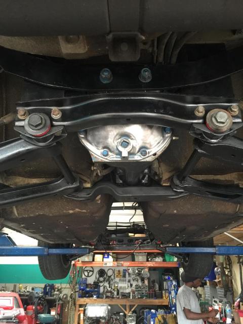

October 29, 20159 yr Author comment_480055 R200 in with new bushings, new MSA spindle pins, bearings, etc. Glad the floors are in good shape. Link to comment https://www.classiczcars.com/forums/topic/48954-my-best-260z-yet/?&page=2#findComment-480055 Share on other sites More sharing options...

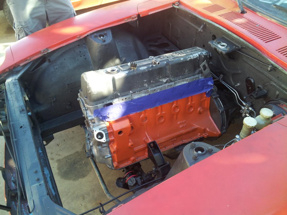

November 1, 20159 yr Author comment_480234 Cheers, Brakes are working now (stock setup), new MSA solid diff mount went in today also. Valve cover just used for install, it will be an NA motor (: Link to comment https://www.classiczcars.com/forums/topic/48954-my-best-260z-yet/?&page=2#findComment-480234 Share on other sites More sharing options...
November 3, 20159 yr comment_480404 dontcha just love all the space around these motors? it always makes me happy to look down and see grass on both sides of the block - unlike anything newer where god forbid you drop a tool in the bay cause you'll never find it again... looks great - fun thread to follow! Link to comment https://www.classiczcars.com/forums/topic/48954-my-best-260z-yet/?&page=2#findComment-480404 Share on other sites More sharing options...

November 11, 20159 yr comment_480871 Cheers,Brakes are working now (stock setup), new MSA solid diff mount went in today also. Valve cover just used for install, it will be an NA motor (:Have you used the solid mount before? They're known for fatiguing the mounting points and failing, plus transmitting much noise. A better option maybe - http://www.technoversions.com/DiffMountHome.html Link to comment https://www.classiczcars.com/forums/topic/48954-my-best-260z-yet/?&page=2#findComment-480871 Share on other sites More sharing options...
November 14, 20159 yr comment_480993 I would have to agree with Zed Head on the noise issue. In racing its not so important, but for a street car it's going to be noisy.There is a thread here with a post about another option made by a company in Australia, just can't find the thread right now. If you are handy you can make it yourself.It basicly uses a front control arm inner PU bush. You need to order to bushes to get the longer section. A section of thick walled pipe (machined to suite the bushes) is welded into the cross member. A U bracket bolts onto the diff like the original and goes over the crossmember with a bolt through the pu bushes.Btw: Great job your doing. Don't see many 260Z around and your project is also specaial in the way you are removing the V8 and installing an L6.Looking good Edited November 14, 20159 yr by EuroDat Link to comment https://www.classiczcars.com/forums/topic/48954-my-best-260z-yet/?&page=2#findComment-480993 Share on other sites More sharing options...
November 14, 20159 yr Author comment_481016 Thanks fellas, will see how it goes once its up and running. Link to comment https://www.classiczcars.com/forums/topic/48954-my-best-260z-yet/?&page=2#findComment-481016 Share on other sites More sharing options...

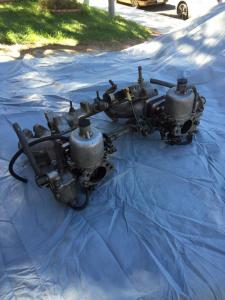

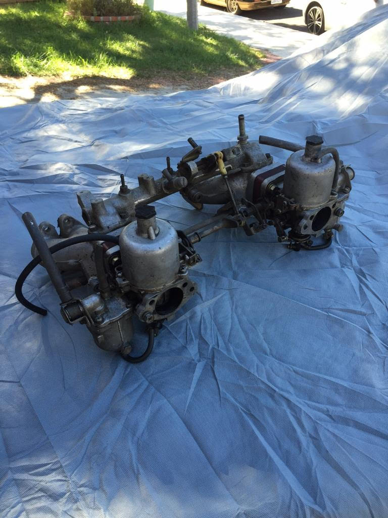

January 25, 20169 yr Author comment_485370 Creeping back into L land..... Edited January 26, 20169 yr by grnsky Link to comment https://www.classiczcars.com/forums/topic/48954-my-best-260z-yet/?&page=2#findComment-485370 Share on other sites More sharing options...

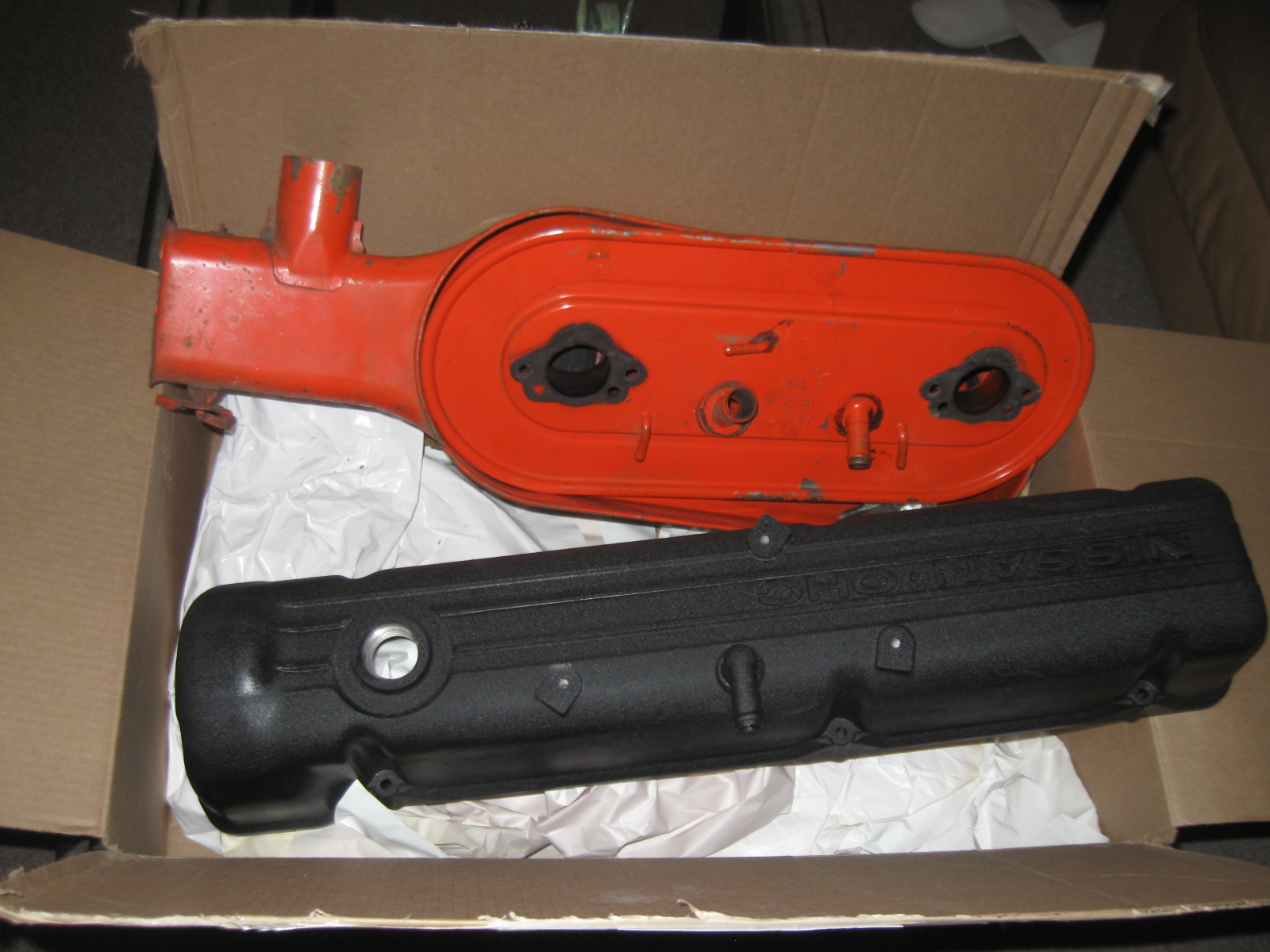

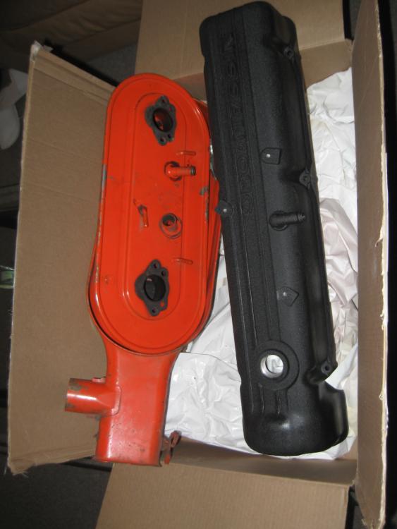

February 15, 20169 yr Author comment_486504 Thanks Rossiz, More parts for the engine, coming along slowly (: Link to comment https://www.classiczcars.com/forums/topic/48954-my-best-260z-yet/?&page=2#findComment-486504 Share on other sites More sharing options...

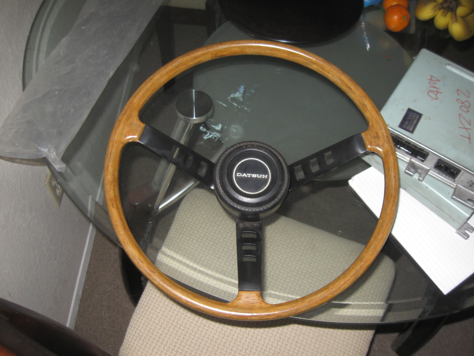

March 19, 20169 yr Author comment_489630 Right wheel, wrong color, will do for the interim! Link to comment https://www.classiczcars.com/forums/topic/48954-my-best-260z-yet/?&page=2#findComment-489630 Share on other sites More sharing options...
