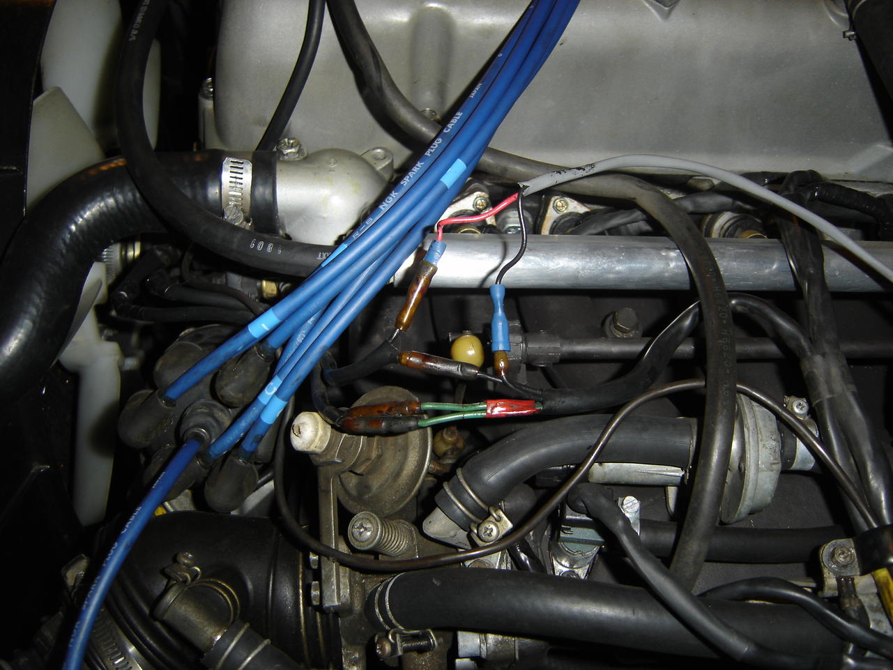

If you do decide to do the potiometer route a volume knob at Radio Shack is pretty much what I got. Here it is, 10K-Ohm Linear-Taper Potentiometer : Potentiometers | RadioShack.com. You put the bullet connectors on then plug it in between the original bullet connection on top of the intake. I ran mine inside the car so I could play with while driving. It worked wonders without doing any kind of damage to the existing wiring for less than $5. If it didn't help I could just unplug it and plug the old wires back together. That was for testing, now I want 1 like Fastwoman has that goes under the dash with the ecu. Her's is a lot more precise.
